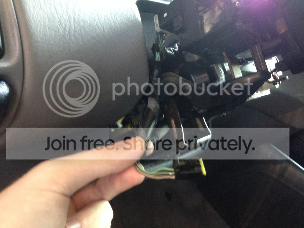

Still can't find an ecu. Took off the column cover to see if anything was grounding out there and I found that this was unplugged but I couldn't find a place for it to plug back in? Anybody know?
