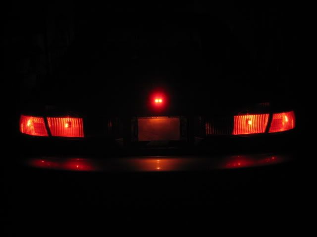

what you can have done, is take it to a body shop, and a good body shop would fill the holes with weld, sand it down, and repaint it. thats the correct way to do it. i, personally thought the H emblem on the back of the car was too small, haha, so i custom upgraded mine:

i used to have white LED emblem on my front grill. now it doesn't work so i threw it away. =)
