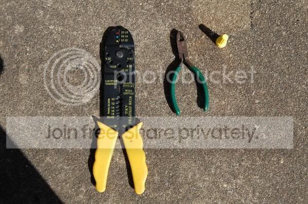

TOOLS NEEDED: wire strippers, wire cutters, twisty cap.

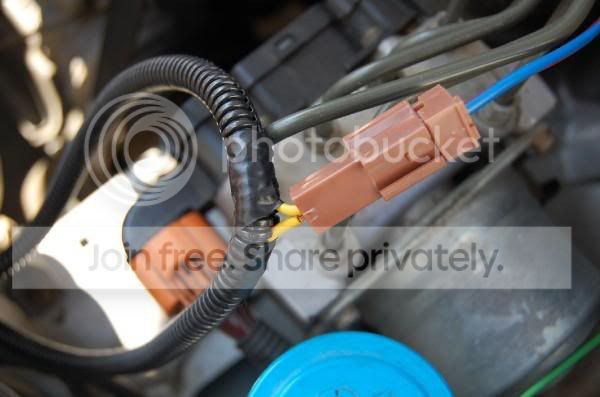

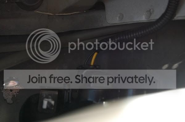

STEP 1- locate the wires coming from the foglights, one should be black (ground) and the other will be another color (mine is yellow) this is the power wire.

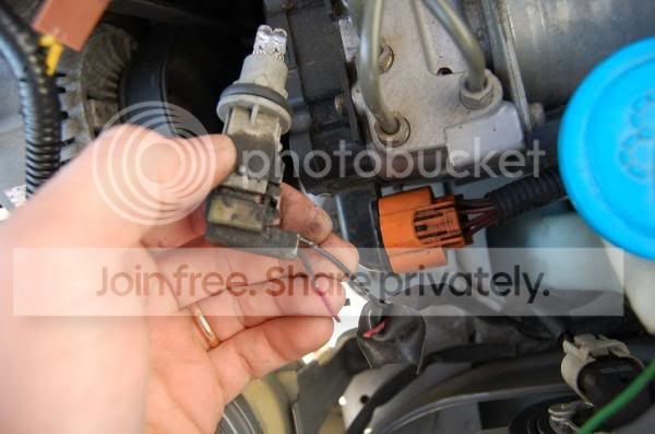

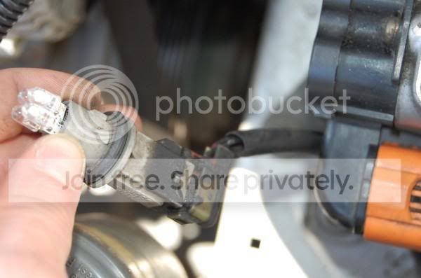

STEP 2- locate the small parking light at the bottom of the headlights and remove it

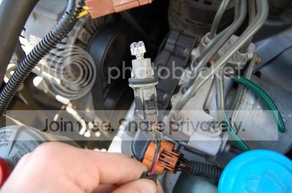

STEP 3- pull back the covering on the wires and youll notice theres one red wire (power) and one black wire (ground)
STEP 4- use your wire cutters to cut the red wire, and use your wire strippers to strip back each end.

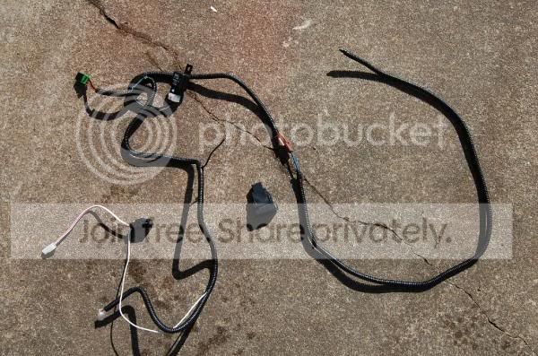

STEP 5- now if your harness is like mine it has 3 sections. section 1 has the connectors to the bulbs and the power and ground wires, section 2 is like a bridge, its just 1 wire (mine was blue with a red stripe). section 3 will be removed completely, it has the switch, relay and all the wires that have to do with that stuff. you need to find where the power wires from section 1 go into the bridge wire from section 2.

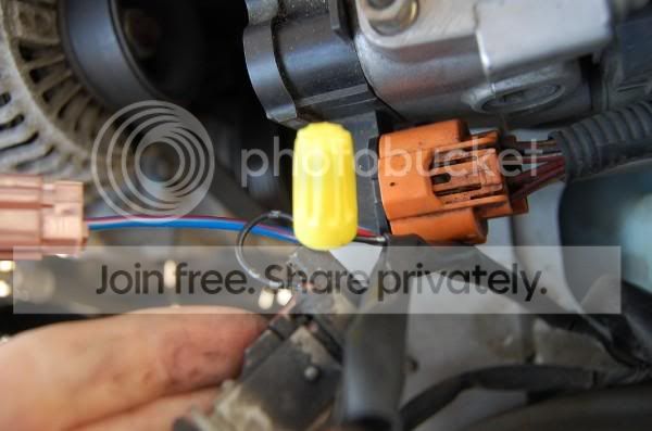

STEP 6- now theres 2 ways to do this you can either take the power wire from each fog light and cut those, or (if your harness is like mine) i cut the bridge (section 2) since its just 1 wire. whatever you cut use your wire strippers to strip off the end. (no pic, sorry)

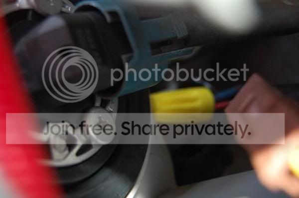

STEP 7- now take all the ends that you cut and stripped and twist them up in your twisty cap.
STEP 8- put your bulb back in the socket.
STEP 9- now pull out the rest of section 2 out and pull all of section 3 including your switch and relay out. you no longer need any of this.

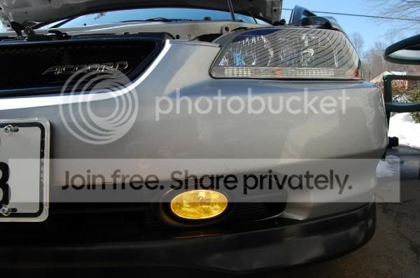

STEP 10- now give it a test! make sure they come on and go off with the parking lights.
