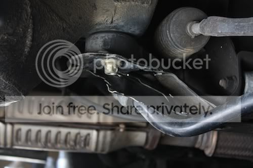

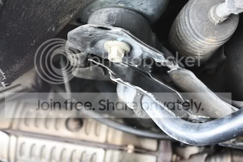

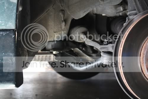

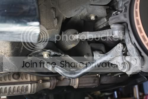

im lowered on H&R sport springs on OEM shocks and i think about a week ago, all of a sudden, whenever i hit a certain bumps but not all bumps on the road, i hear clunking/claking noise coming from the right passenger side wheel. at first i thought it might be my CAI loosesly hitting against the frame of the car, so i tightened that up, but the noise is still there. i took out the wheel in that area to look if everythings okay and everything seems fine. i check to see if the shock is blown by pushing down on the shock and it doesnt bottom out or anything, it springs back up like normal. could it be my shock is blown? i will record a video so you guys could have a better understanding of the noise.

Are the strut tower bolts tight?
Check ball joints, tie-rods, endlinks, bushings and axles.
i dont thinnk its the main relay since i replaced it with a new one like a year or 2 ago. and there was a little bit of corrosion on my battery terminals but i sanded that out.
i tried to tighten the strut tower bolts but it doesnt seem to be tightening :thinking:

And number two: This is sound/experience of a lower ball joint going bad. In addition, you should never lower on stock struts as this will cause them to fail prematurely. It's probably a combination of the two, depending on you driving style, location and maintenance intervals. Hit any large bumps or potholes lately?

#1. might be ignition switch. andy had his replaced 3x already, i think. and my accord's on its 2nd replacement.
#2. check your endlinks.
