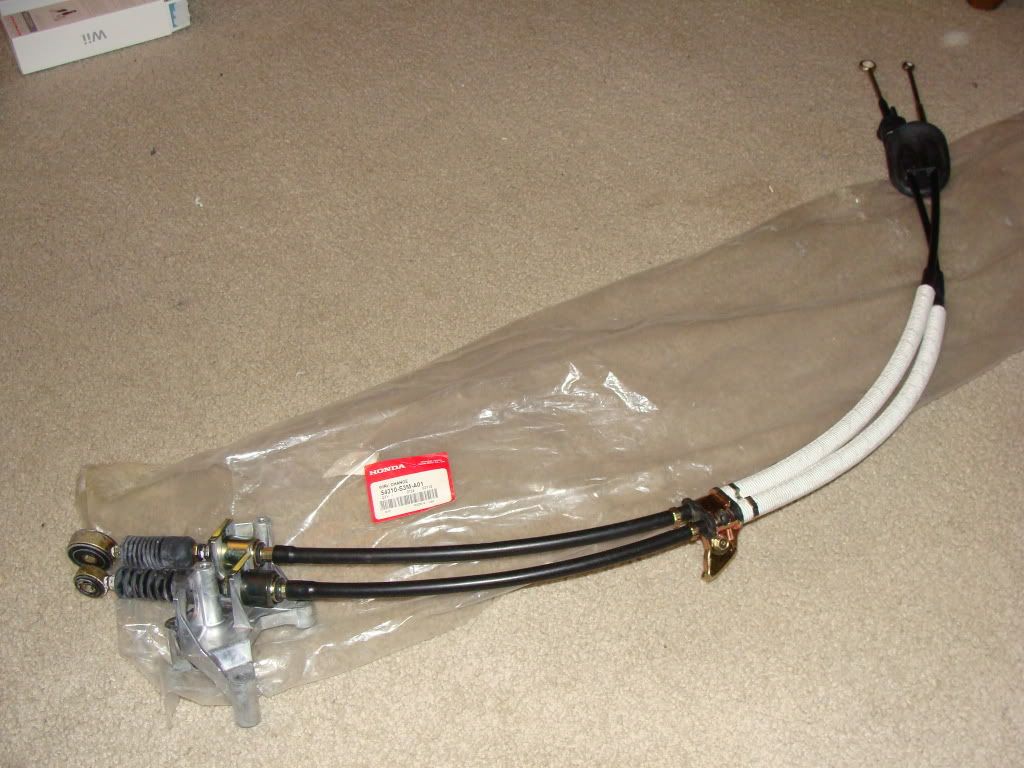

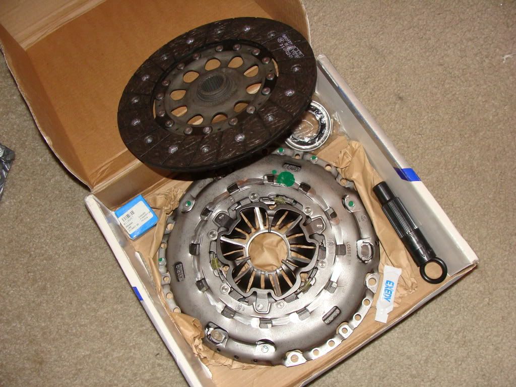

Parts (pre swap):
7G AV6 6spd tranny
Exedy Clutch Kit
CL Type-S shifter cables

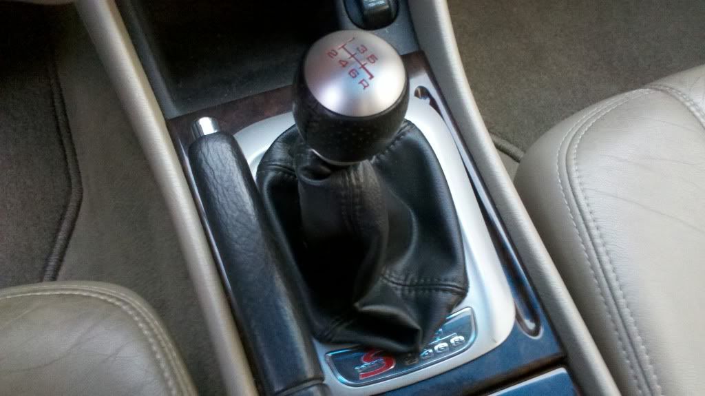

Progress (post swap):
Finished (day of swap completion):
