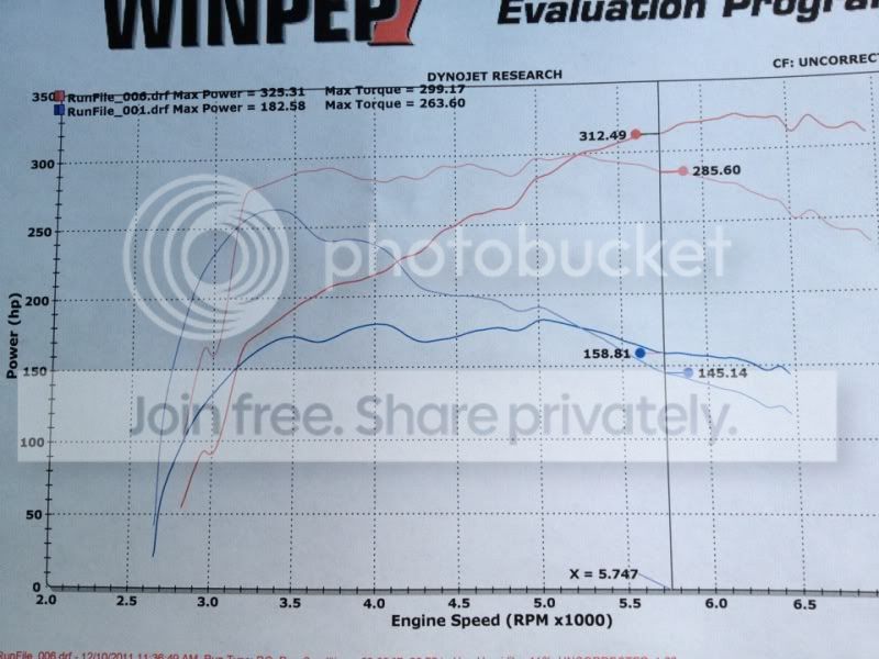

good numbers, hoped for higher but i maxed out the timing. The FIC you cant advance timing but you can subtract. Started in negative degrees and worked our way back to 0. Once at 0 theres nothing more the ECU will allow, 0degrees is the failsafe of the 3.2 Acura ECU. Need to get a stand alone ecu. Said i could easily get another 40-50 hp out of the setup.
Base run of how the car was running, with everything installed and not adjusted was only
182.58 whp 253.60 lbs of torque
after 1 tweat, it was at 270 hp.. another tweak 312 hp
Maxed out timing on stock ECU at 325.31 whp and 299.17 lbs of torque on 7lbs of boost
Dyno Video(was so much better with the music.. ****ing youtube
