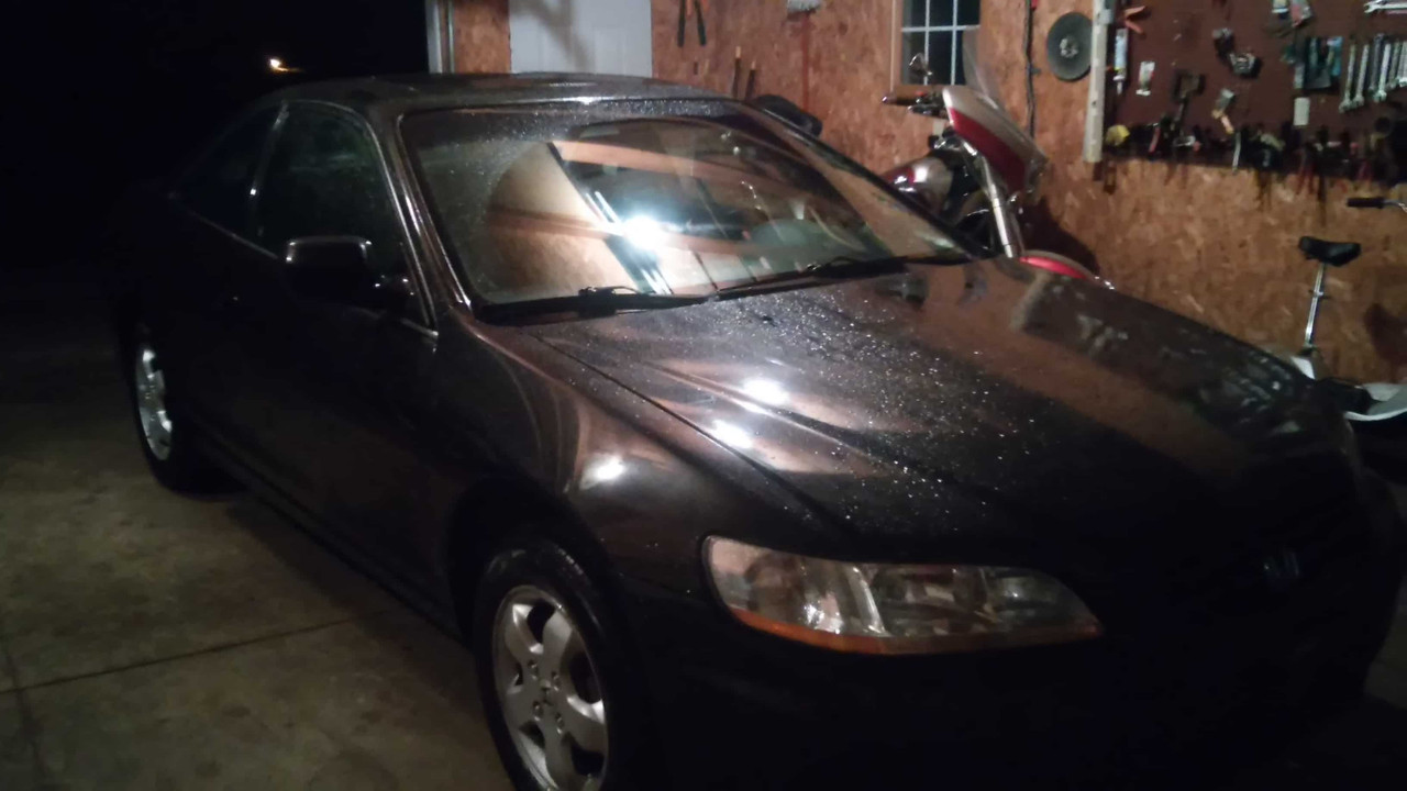

This is it about 5 minutes after driving it back from Columbus and about 5 minutes before my mom would tell me that I bought a piece of junk.
The car only had 133,000 miles on it and only cost me $3000. I noticed the car was idling a little bit rough at the dealership but other than that it seemed to run ok. It also had a few other problems like the ABS and cruise not working. The car also suffered from having an owner that didn’t give it the TLC it deserves. The car has been repainted with spray paint where the clear coat was peeling and it wasn’t repaired properly after having a fender bender in 2004. The hood did not line up at all and I had to reposition the latch and rubber bumpers to get it to line up with the fenders but there’s a big gap between the hood and bumper.

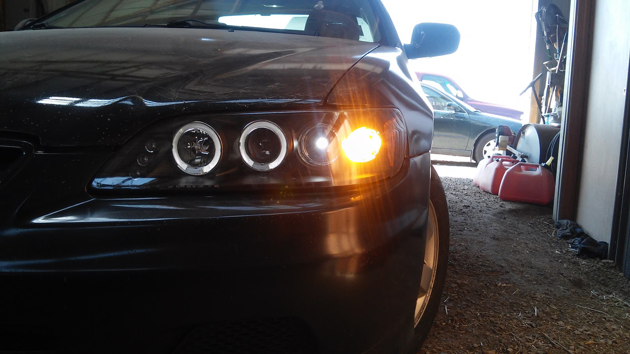

Retrofitted headlights with HID projectors (Morimoto clones)
Switch Back turn signals

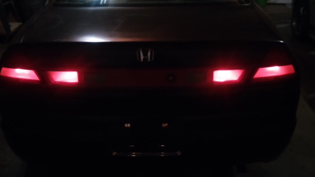

Disabled DRL on top half of triangle tail lights (I have since reverted back to having them lit)

1/4/2017 retrofitted headlights with Morimoto clones and installed them in the car.
