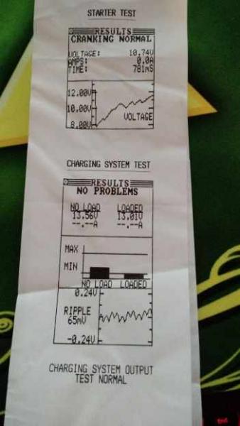

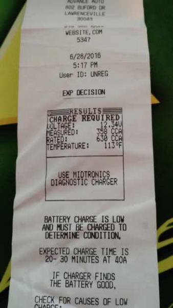

There was an Advance Auto across the street, so I had them test everything.
(Tried to upload pictures to this thread, but apparently 18kb file sizes are still too big and trying to link from my profile is "invalid")
http://www.6thgenaccord.com/forums/picture.php?albumid=1356&pictureid=7689
http://www.6thgenaccord.com/forums/picture.php?albumid=1356&pictureid=7690
In short, I was told my alternator is shot and is just draining my battery at the same time.
