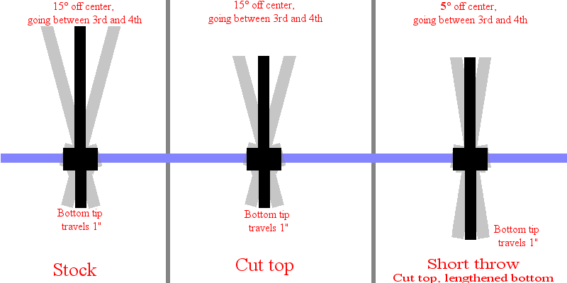

Are you saying a cut shifter with the same ratio as a SS would produce the same effect? because if so i'll have to say i disagree...granted the ratio is the same, being as the SS is longer shifter compared to oem, the shaft above can reach an appointed distance quicker due to the pivot point angle being decreased...
heres a pic to show what i mean
