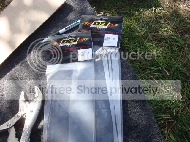

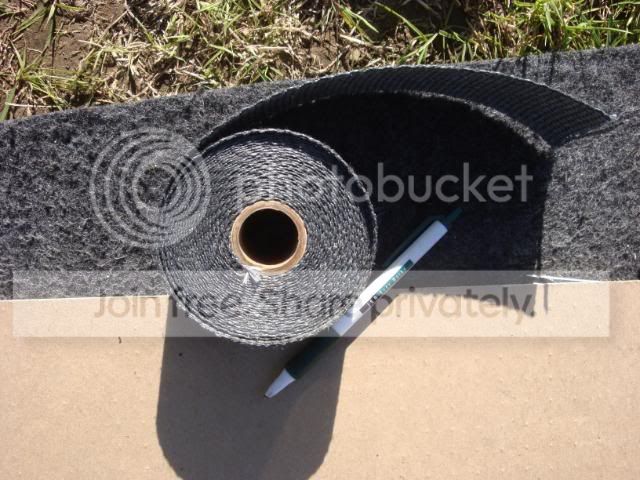

I have XS-Power headers
Supplies Needed (summitracing.com)
- DEI Header Wrap 50' x 2" (I used Black PN: 010108)
- (2) 8 Pack 8" Aluminum Ties (14 Needed in total for V6) PN:010201
- 4 Pack 14" Aluminum Ties (2 Needed in total for V6) PN: 010202
- Tape Messurer
- Rubber Gloves (wrap contains fiberglass which will make you itch)
- Metal Cutting Plyers/ TinSnips/Scissors (Cut wrap to size, and cut excess off metal ties)

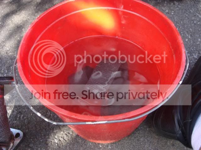

- Bucket of water

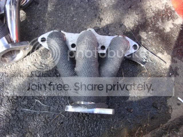

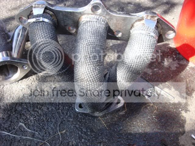

This process is easiest done with headers off the car. Use the bucket of water to soak the wrap, which makes it easier to wrap around the pipes. When you pull it tight it will slightly expand, and when it dies it will contract for a nice tight wrap.
*NOTE: Wrap as tight as POSSIBLE.
1) Middle Exhaust Ports (both sides)
- Cut 2 strips 2ft 6inches long. (30 inches)
- Soak in water (a few seconds will be fine, it's just to make it flexible)

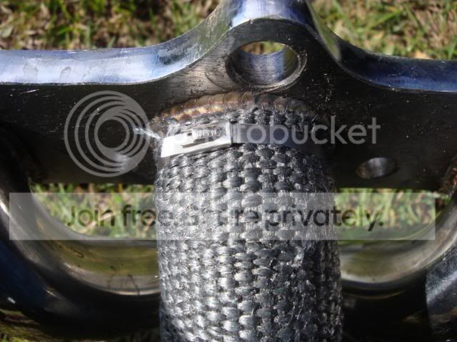

- Take 1 strip, overwrap about an Inch, so you can pull and it doesn't slide off. Use a about a 1/2" overlap down the pipe.
- After you get a few inches down apply 1 8" Metal Tie to the top of the pipe(this is to make sure it wont come off as you continue down.) Cut excess of the tie off
- Wrap in the same process until the bottom and then overlap once.(you should have just enough to do so.
- Apply 1 8" metal tie to the bottom. cut excess off
- Repeat on other side
2)Outside Exhaust port (left or right, it doesnt matter)
- Cut 2 strip 3ft long (36 inches)
- Repeat the same process above
- At the bottom, overlap with the middle pipe, this will insure that you are covering everything.
- Apply the metal tie over the pipe you are in the process of wrapping, and cut excess off

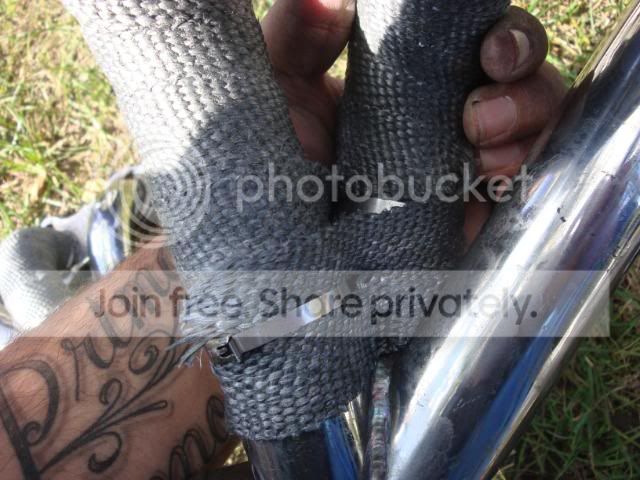

3) The Last Outside Port
- Cut 2 strips 4ft long (48 inches) (this includes the extra to wrap around all 3 at the bottom)
- Repeat steps from # 1
- About 2.5" from the bottom start to overwrap all 3 pipes (this is where you use the 14" metal tie)
- Wrap as tight as possible and apply 1 14" metal tie(cut off excess)

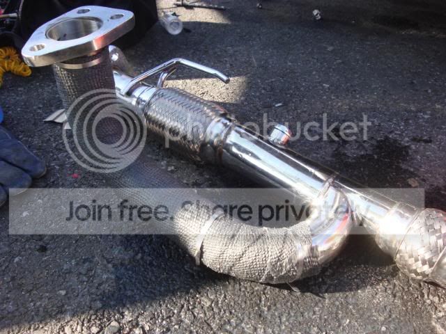

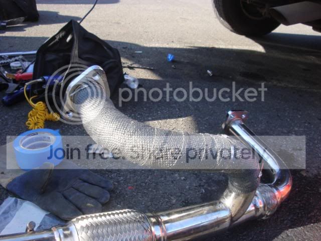

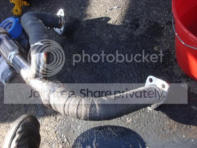

4) J Pipe
- Cut 1 strip 7feet 6inches long (90 inches) (this is for the 1 bend side)
- Cut 1 strip 8feet long (96 inches) (this is for the J bend side)
-repeat same process as # 1 using 2 8" ties on each side( top and bottom)

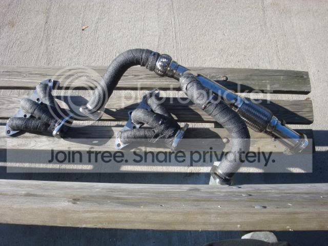

Finished Product.
extra wrap left over
