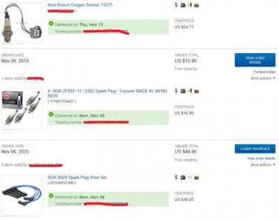

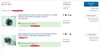

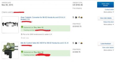

Hey guys, Y'all must remember when I use to ***** and complain about my braking on the car. I search the entire Ebay for a cheap upgrade and found two for sale but I bought the one with the brake cables etc.... Then I realize my CAT rotted out so I bought some Imitation parts off Ebay.

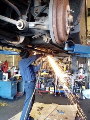

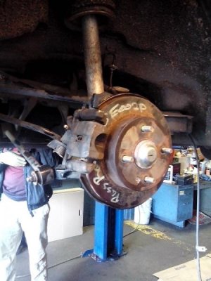

Yeah the EX model, and boy they are hard to find. I just cut off the rear ABS sensor wires. The brake response is firm and sharper since I swap out the drums which I hated. These are some simple cheap MODS I always recommend to Newbies.

Make sure to get the brake hose and E-brake cables with that disc hub spindle knuckle very important.
