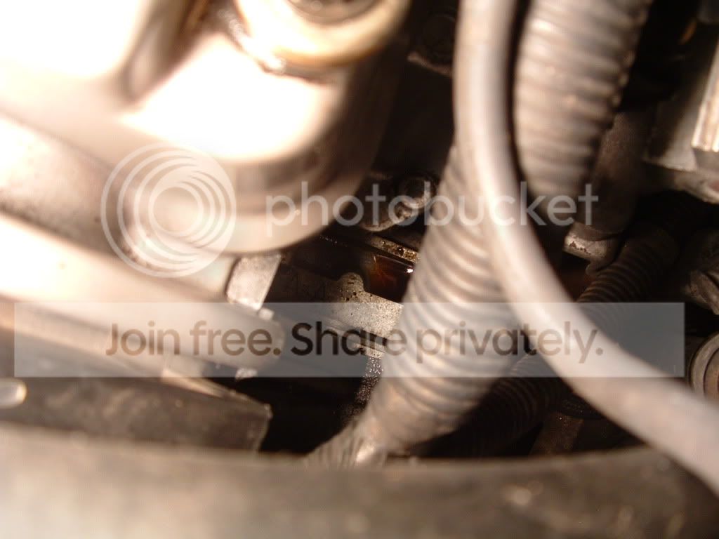

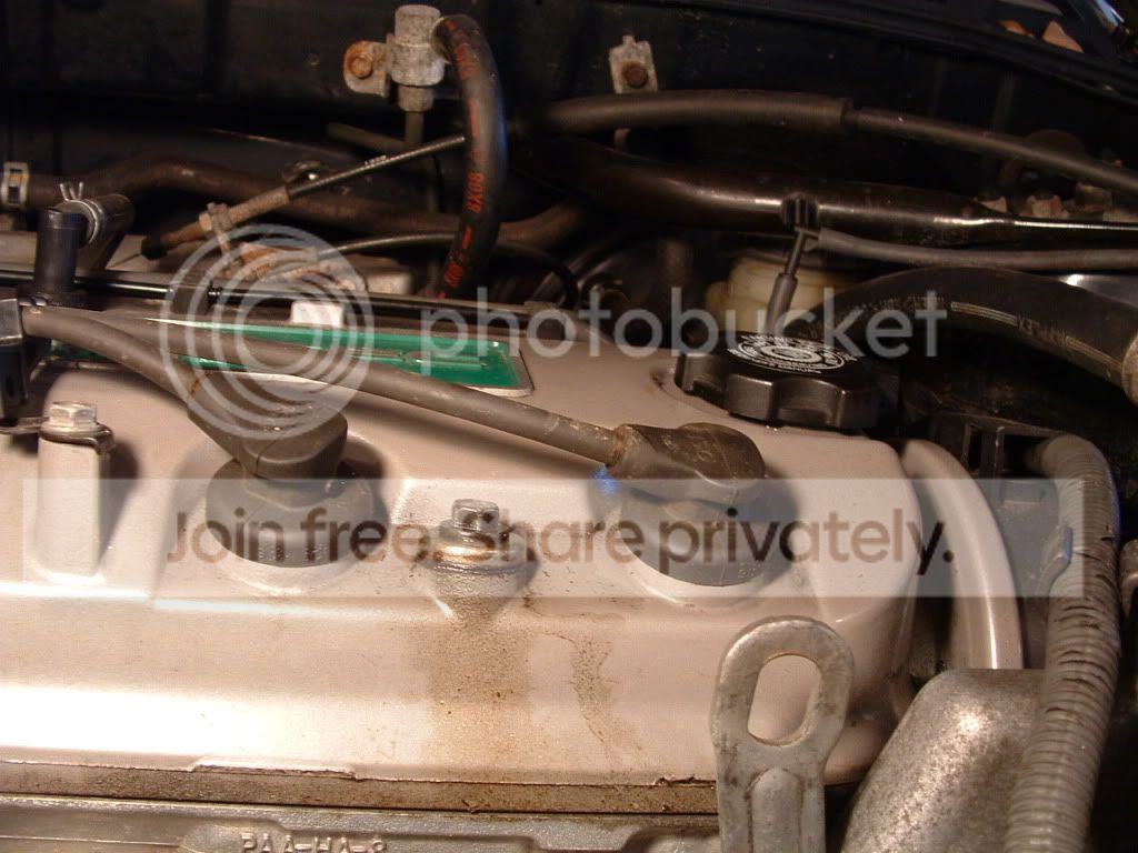

I noticed yesterday when i checked my oil dipstick, how low the oil level was..below the "low oil mark". I could see a small amount of oil leaking down from the valve cover bolt grommet, and possible the valve cover gasket as well, but didn't think it would account for such a large amount of oil loss over the course of 3000 interval oil change. There was also some oil on the backside of the engine. I am hoping it just needs a new valve cover gasket install. There was also a small pool of oil behind the timing cover. Could a warped head or bad head gasket cause oil to leak externally? I checked the coolant and it looked fine...full and no signs of oil.

When was the last time you had your seals changed? Or, when was the last time you had your TB changed? Your crank, cam & balance shaft seals should have been changed out. Maybe your balance shaft seal popped out because you don't have the retainer. Something not a lot of people know about. Try changing your valve cover gasket and spark plug tube seals & re-torquing those head bolts.

Yes, a valve cover leak can be really bad. And bad enough to help you lose a qrt of oil. The seal becomes dry and cracks.
You may use rtv gasket sealent. Just make sure u let it sit about 5 min before attaching the valve cover. And then give it atleast 12hrs to cure before u get ur car all hot again.
You look like u have a pretty good leak there, i would make sure ur valve cover bolts are tight or the o-rings are not cracked.
