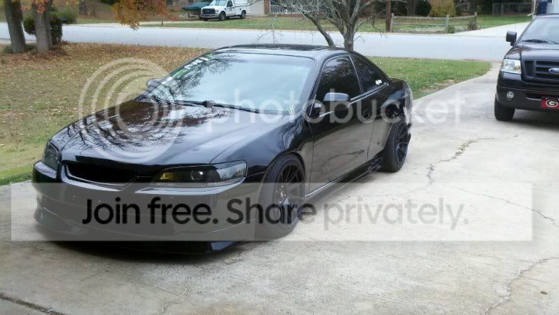

Will be updating this for next few days! last update 2011'
Retuned yet again 7/18/2013: 315whp/310wtq @14psi.
Car is always changing.Always can be better or Different.I built it for my style and taste.Please enjoy and leave comments.
6/1/13:

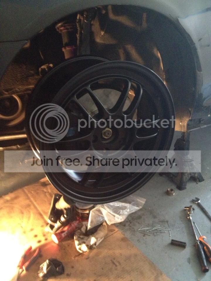

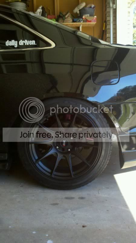

5 lug conversion with some 17x8 RPF1s

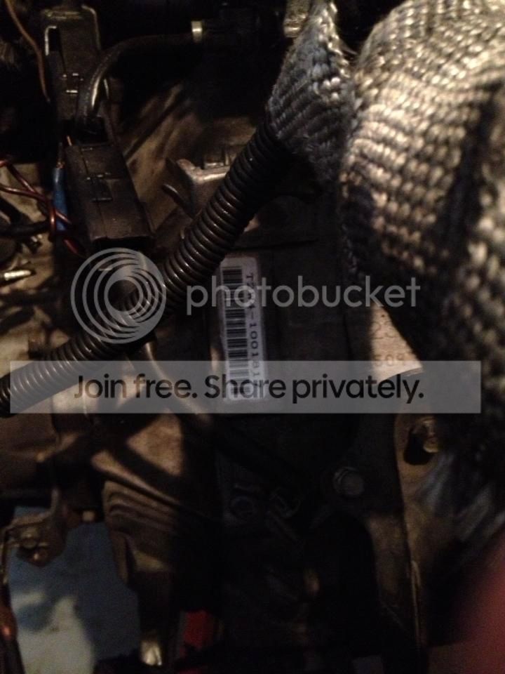

Tranny swap:

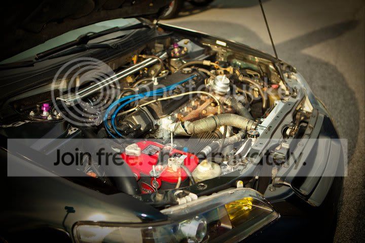

Engine / Performance
2.3L F23A1,5 Speed
Treadstone Cast Turbo Manifold
Treadstone Bar and plate Intercooler
MC Custom welded 2.5" IC piping w/Treadstone black 4ply couplers
TiAl 38mm Chrome wastegate
Garrett 60-1 turbo .48hotside- custom painted lime green
MC Custom welded 3" Straight pipe exhaust w/Skunk2 Mega power turbo muffler
MC Custom 3" downpipe with 3"flex pipe
Mishimoto Alum Rad.with Slim fan shroud combo
Precision 440cc injectors
RC obd2-obd1 injector clips
AEM EMS standalone Version2
GM 3bar Map sensor
Walbro 255 infuel pump
HKS ssqv special edition black BOV
Bisimoto level 2 turbo cam
Bisimoto adj. cam gear
Bisimoto Pro valve springs
ARP h23 Headstuds
T2W4 H22 LSD Transmission rare swap
ACT Xtreme Clutch kit
XACT 12.6lb Flywheel
Suspension
D2 Racing Coilovers 36 adjustable
Acura Rear sway bar
Moogs swaybar links
Ultra Racing 4pt subframe brace
Interior / ICE
Kenwood double din W/Garmin Navi
3 gauge piller pod
2 gauge center pod
AEM AFR Wideband gauge
Autometer Cobalt Boost/Vac Gauge
Autometer Cobalt Water Temp gauge
Dragon Digital oil pressure gauge
apexi Turbo timer
Pspec adj short shifter
skunk2 440g weighted shift knob
shortened OEM leather boot
Mugen Pedal covers
Recaro Style black/red stitch racing seats
Weapon R seat brackets
Flat black harness bar
Black 4pt harness
4-Recaro harness shoulder pads
Cosmetic
nighthawk black blue pearl paint job
Custom Rainbow peral engine bay paint job
5 Lug conversion
17x8 +45 Eneiki RPF1 flat black
Front Tires:245/45/17 Mickey Thompson Street Comps
Rear Tires:245/45/17 Falken
Mini HI retro fit
6K bulbs
WW Type W sedan front lip
Xenon sedan side lip
WW coupe rear lip

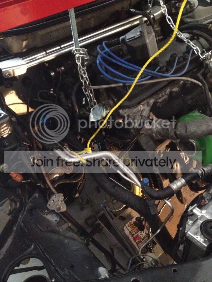

11/20: New Turbo kit fabricated,now need to tweek fitment on exhaust.once reinstalled.
Sneak peak of my custom fabricated 3" exhaust to Skunk2 Mega power muffler.

I like how it looks now too... But don't like the wheels much at all :-\

each to there own,but i needed something bigger than my old 17s when i swapped my ebay coil sleeves to real suspension H&R sports with Monroe shocks.its a moderate drop that i needed for DD.so the 19s filled the gap little more..$450 for them so cant complain.
