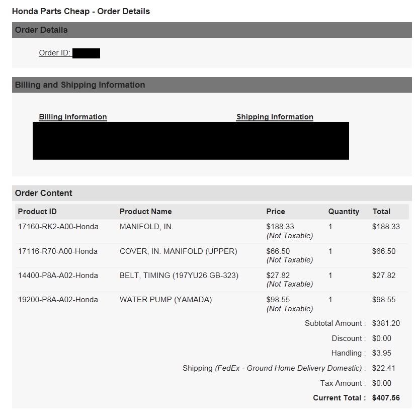

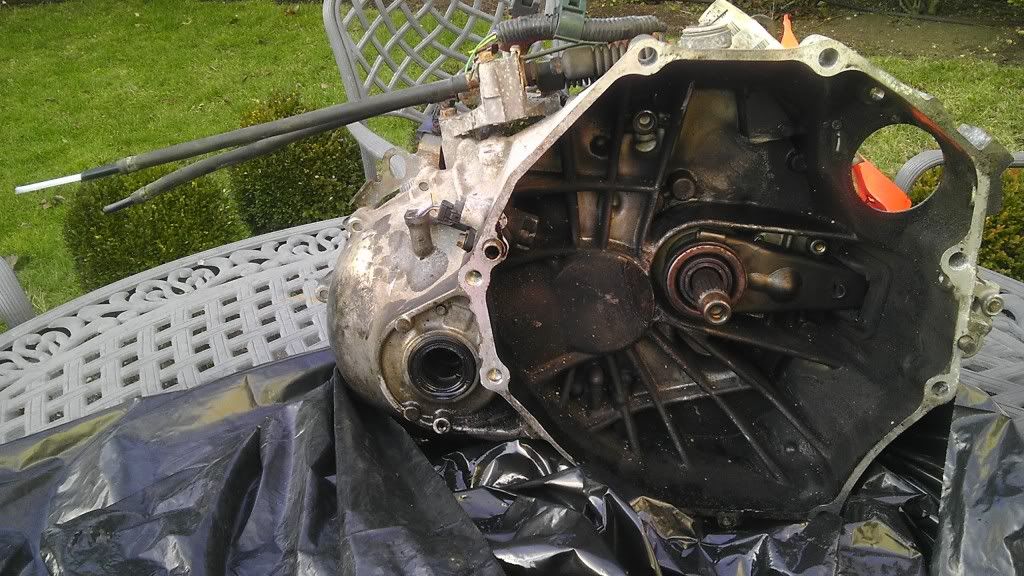

Some receipts and pictures for all of you non believers:
