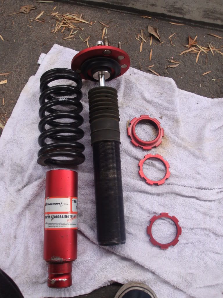

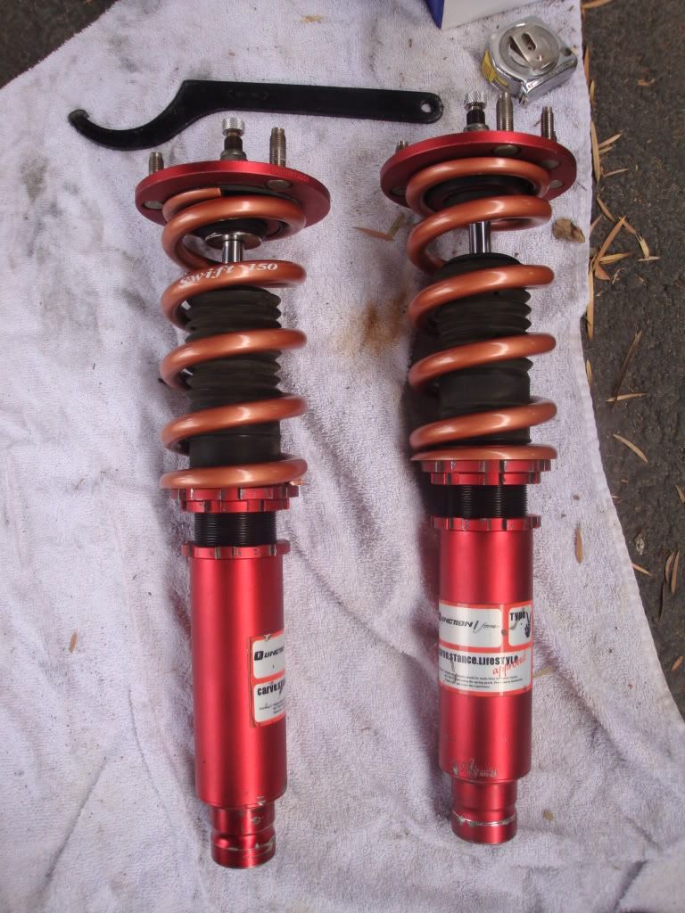

heres a pic of everything out and loose

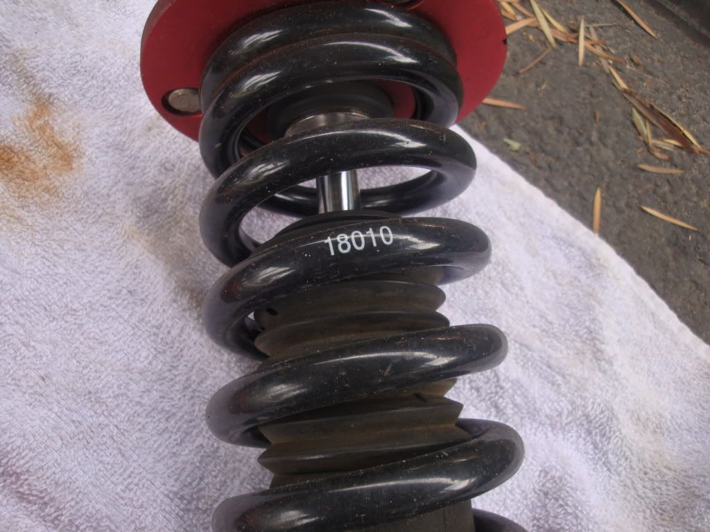

if u take a look these arent ur ordinary type two and by ordinary i mean the ones ken is selling on this forum
i am no expert but i think 18010 stands for 180mm of freelength and 10 for 10kg springrate
step 5 the point of no return

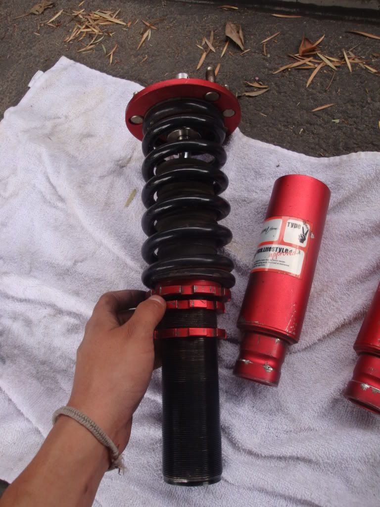

we start by unscrewing the bottom mount then the perches and then u carefully slide out ur spring

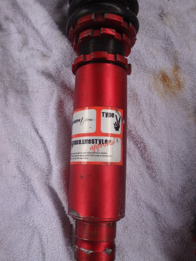

heres everything taken apart

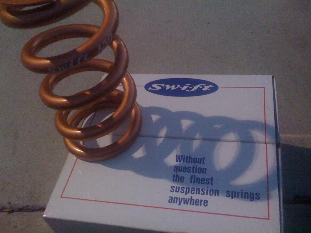

ok so because i live in cali and cali is the **** i drive 40 miles to the city of ontario to the swift springs facility and order me some 15kg springs
i saw this in there storage area
ok so here are the springs

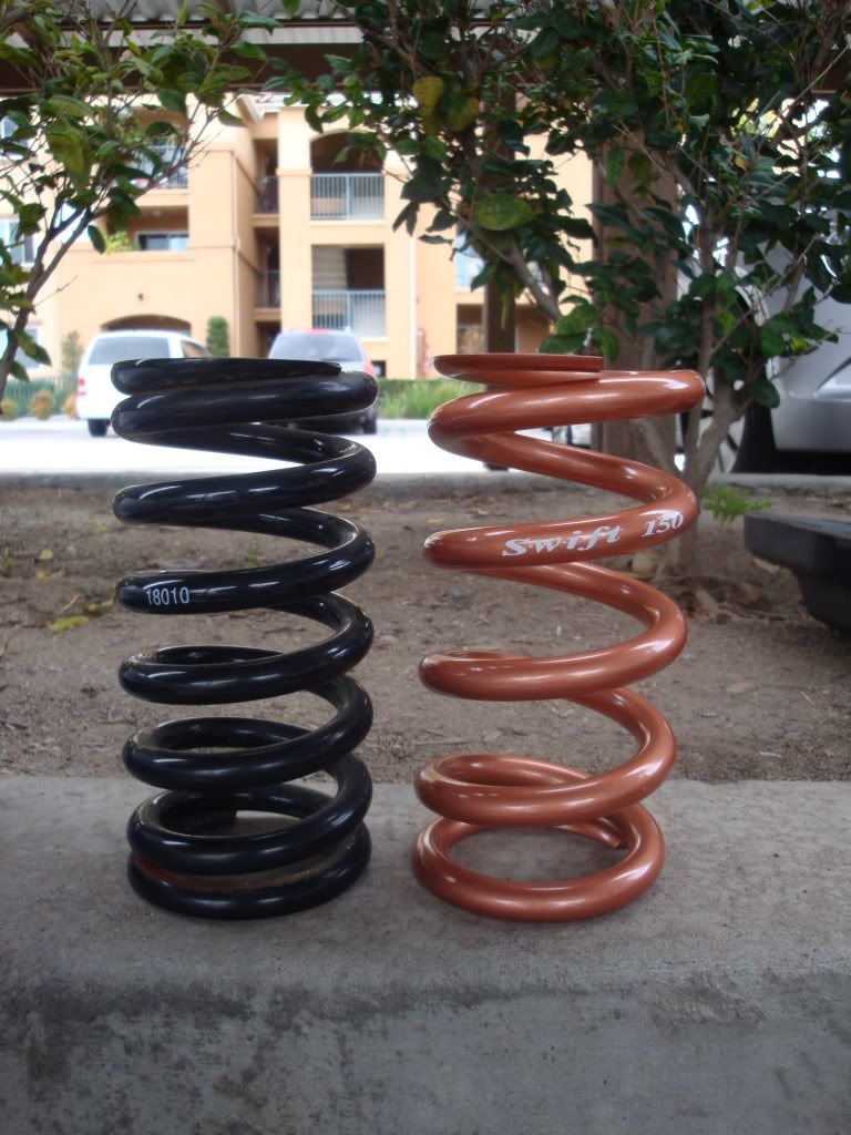

and here are a couple comparison pics of the old spring and the swift spring
according to them less coils translates to less weight and more usable stroke

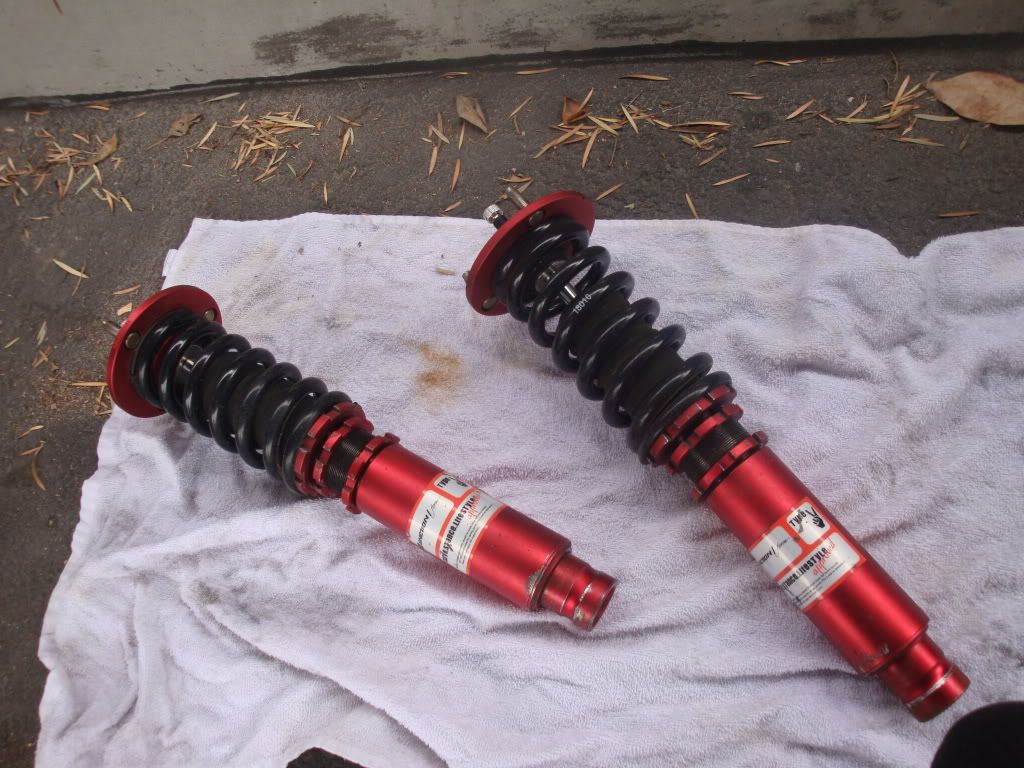

here is another pic
and here is everything put back together
