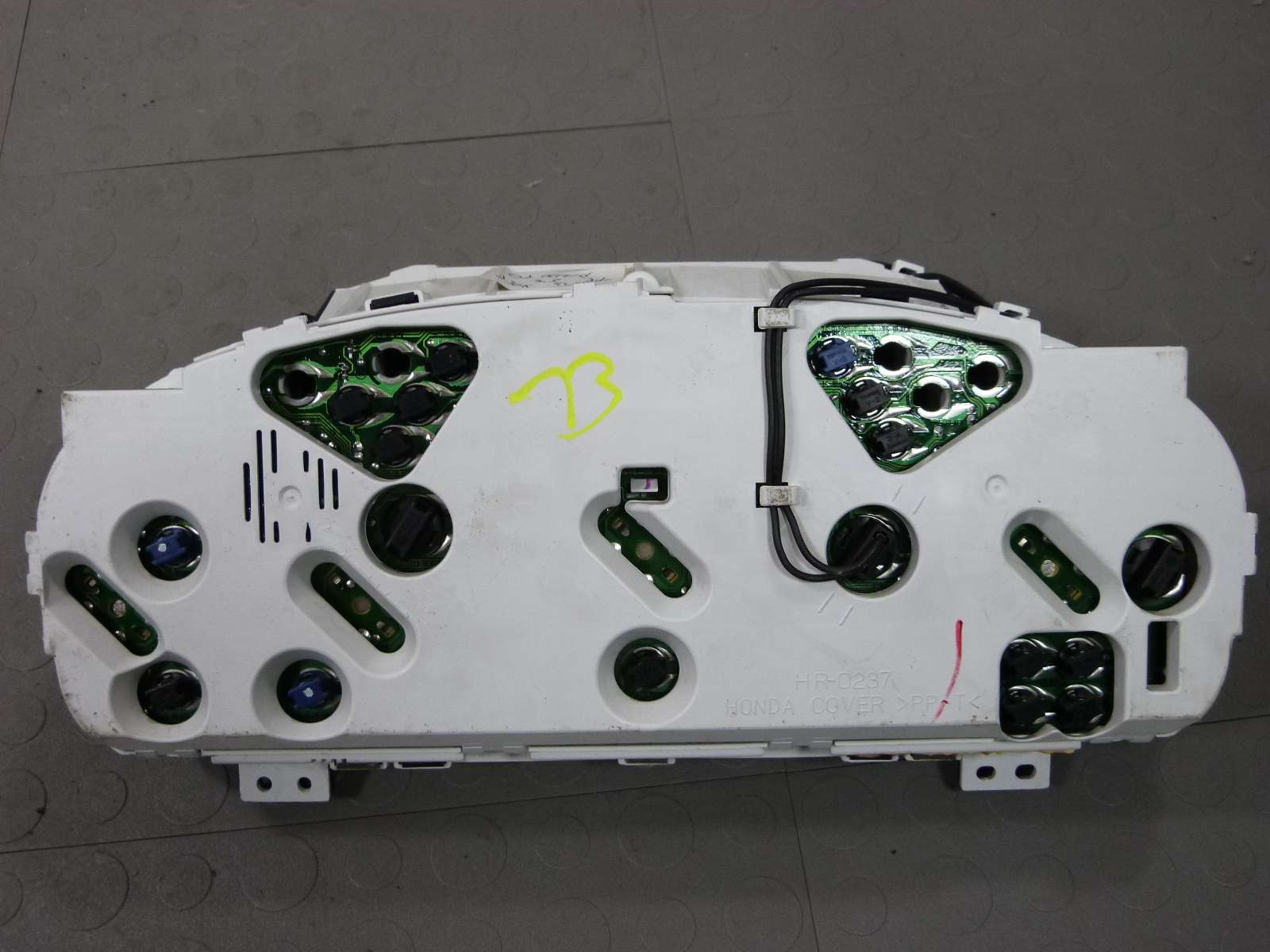

Here is the back of an AT 4cyl cluster. Seemingly doesn't have access to those LEDs.
19,557
138
back of my cluster, vertical column of small bulbs at far left are the gear indicator lights
