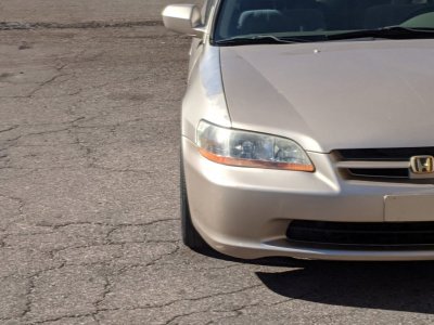

My Accord is dropped 2 inches and I just put 17x7.5s with a +30 offset and they actually fit really well and I've encountered no rubbing so far. You shouldn't have any issues as far as I'm aware. Pics relatedIMG_20200104_132125~2.jpg IMG_20200104_132217~2.jpg IMG_20200104_132150.jpg

Thanks for your input appreciated, so the front lip rim doesn't poke out of the fender ? Seems it comes flush on the picture but not easy to judge by a picture. Also what are yours tyres dimensions ?

Nah, it doesn't poke out at all, it's actually pretty flush but that's with the +28 offset, so yours would have an extra 2mm poking out with a +30 so just keep that in mind. And right now, it's got 205/40R17 tires on it.
