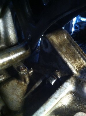

    Thanks you guys for the replies; Matt those are good ideas. No, turns out I failed to remove the bolt on the top, engine side, that I couldn't see and had no idea to look for. Can't remember how the V6 set up differs, but don't remember a bolt here. Now that I know, removing another 4-cyl this weekend I started with that bolt and it was quite straightforward. It requires removing the oil filter, and maybe the exhaust manifold if you want full clearance, and for me a combination of short ratchet extension and one of my longer 17-mm sockets. O/w the oil filter stud is in the way. My photo tries to show the bolt up next to the rear mount bracket, in case another debutant is trying to take out a transmission; you other guys already know. Pain in the butt, IMO. Thanks again. thumbnail_photo.jpg trans bolt.jpg
