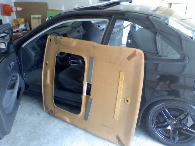

I pulled the whole thing forward to get it free of the rear panels. Once it is free turn the liner sideways to get it out of the car.( If you fold your seats back its a lot easier to remove.

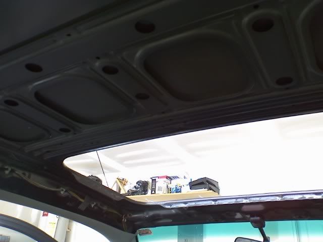

Headliner out.
Then the fun begins. Getting to the slide piece.

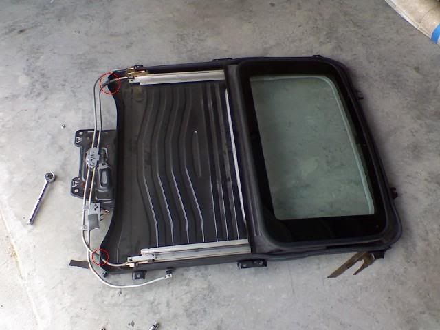

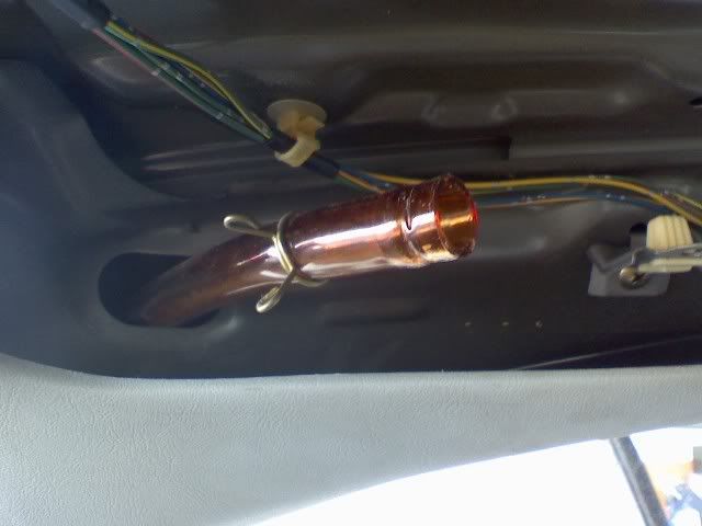

Pinch the clips that hold the brown hose on at each end and pull them off of the nipple.

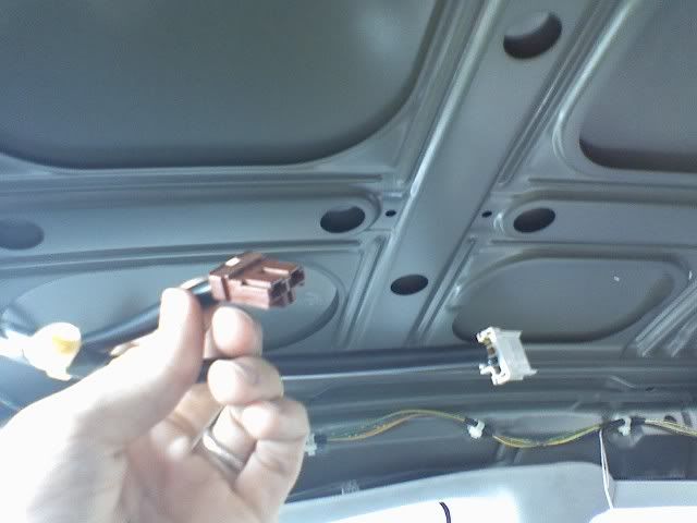

Unhook the 2 connections for the sunroof motor
(there will also be a plastic clip holding the wire to the assemble that needs to be pushed out to get free)
There are two clips that hold the wires for the dome light to the assembly( dont have a picture) remove those also so the light hangs free of the assembly.
Remove the ten(I believe, maybe 8) 10mm bolts that hold the sunroof assembly in. Leave the 2 at the front and 2 at the rear in until last so it will not fall on you.
Once you are ready to lower it down if you have someone to help you hold it get them. If not, lean your seats up with your headrests as high as they will go.
Loosen the 2 rear bolts and remove the 2 front ones resting the assembly on the headrests.
Remove the rear 2 bolts and hold the assembly from falling down.
If you have someone to help you this is where you need them. It is not too heavy but very awkward to remove by yourself. I nicked my door getting it out by myself.
Assembly out

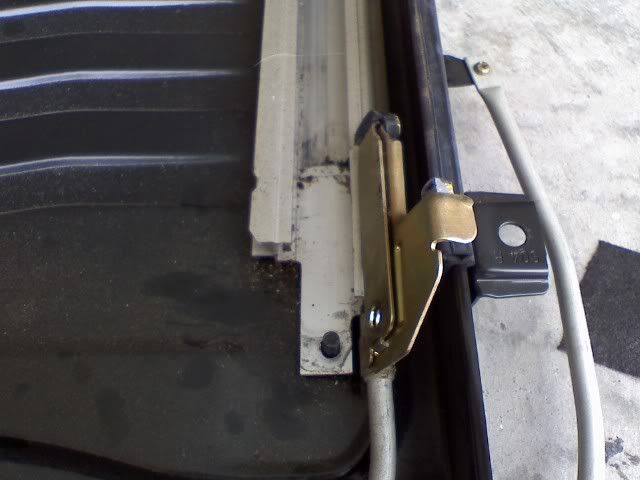

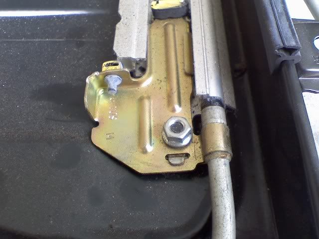

Next remove the 10mm bolts on each side(one per side) of the track for the slide piece.
Remove the bolt and fold that gold bracket up off of the stud so the bumpstop is clear of the track.
Pull up on the metal tubes containing the springs for the slide piece at the rubber grommets(in red) while sliding the slide piece out.
It might take some fighting but it should come easily.

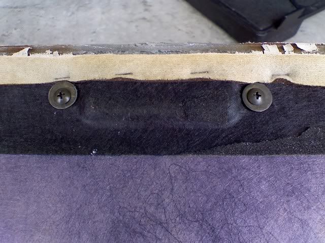

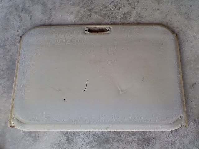

Once its out unscrew the 2 screws from the back to remove the cup handle.

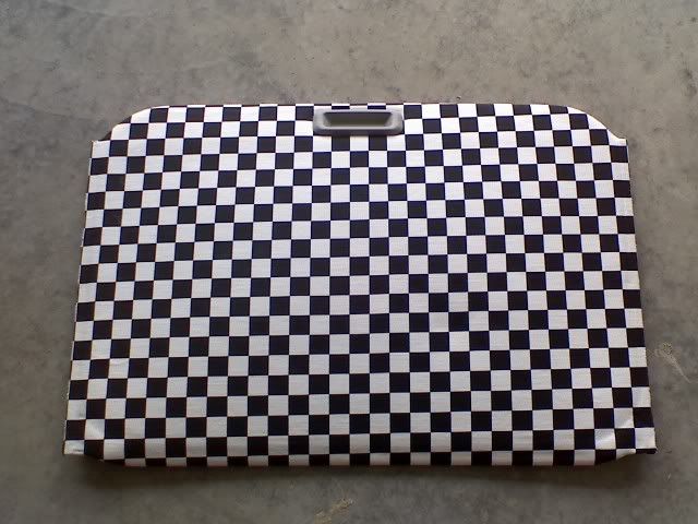

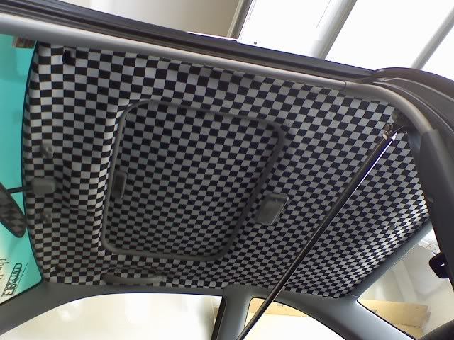

Now that everything is out you can start covering it with the fabric of your choosing
I chose this classic checkered design

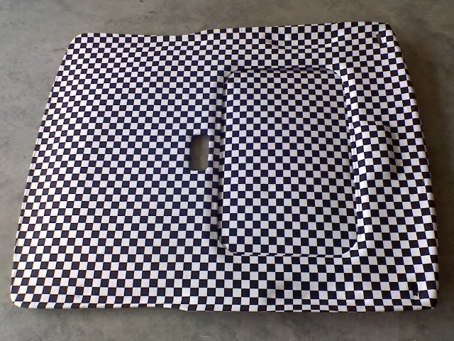

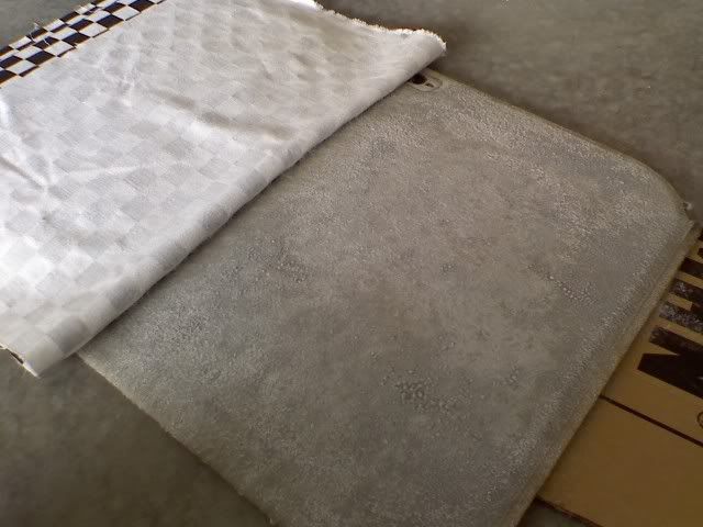

Lay your fabric on top of your headliner and cut it to a little larger than the size of the liner.
Repeat for the slide piece.
One your fabric is the cut, lay it where you want it and fold one side over and spray your glue on the surface and a little on the fabric(not too much or it will soak through and you will be able to see it)
Let it sit a few minutes before you apply the fabric so the glue has time to get tacky.
I used Loctite maximum strength

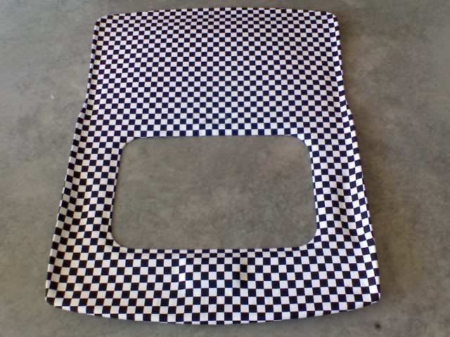

Repeat with the headliner itself.
The easiest way is to hold up one half and work the bubbles out with one hand. If you work quickly you have time to peel the fabric back if you mess up.
Once you have it rubbed on there good trim the excess and cut slits around the corners and in the openings so the material can be folded over and glued down on the other side for extra hold.
I folded the pieces over and tested to make sure they would fold tight and not loose the curve of the backing. After the glue has had time to dry flip the headliner over and spray glue on the backing and the overlaying pieces of fabric and fold them over the back of the liner.
I dont have any pictures of this but once you get all the pieces folded over and glued its ready to dry over night.

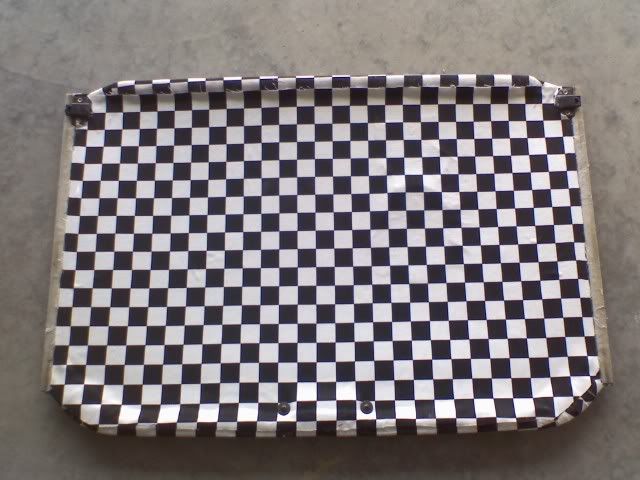

I had already attached the slide handle on there after cleaning it up.
I wanted to cover up the factory backing on the slide piece as it was faded and looked terrible so I cut more material to shape and glued it to the side that would be sticking up to be seen through the sunroof.
With everything but the holes for the sun visors, rear view mirror and handle cut out.

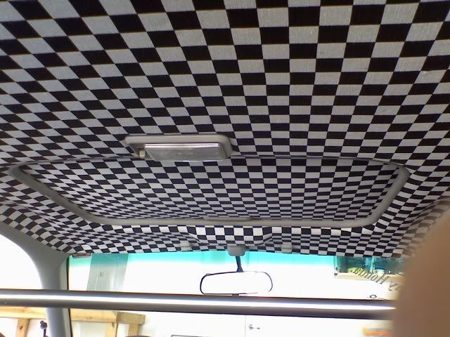

Put the headliner in the car and hop on in there, Its easier if you start in the back I think and pull the panels down over the edge of the liner. it will rest on there so you can move to the front and pull those panels down out of the way and it will rest on there now.
Carefully hold the liner up and pop the panel clips back in by pushing or tapping on them with your fist.
Once the panels are in you can replace the sun visors, rear view mirror, clothes hanger and handle. Don't forget to pull the dome light back through the opening or it will be hard to get back out(I did this
Replace the dome light bolts(two 8mms)
Push up on the liner while you run your finger or a phillips screwdriver(anything round) between the sunroof opening rubber and the liner to get it around it.
Once its around there push up on the liner again to make sure its seated well.
Double check your panels to ensure they are tight and your done!

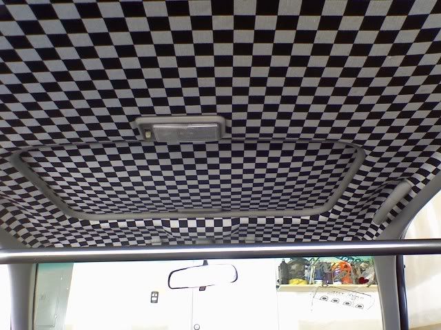

Finished product.

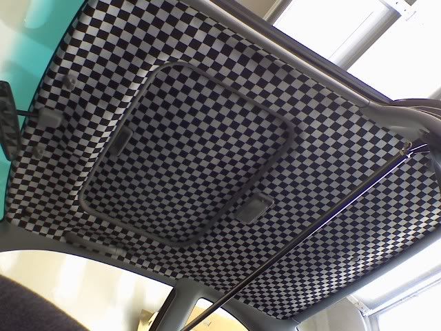

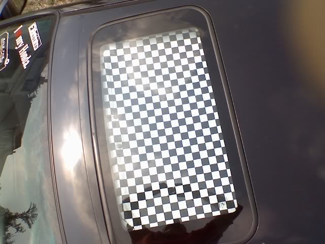

The view from the top of the car.
