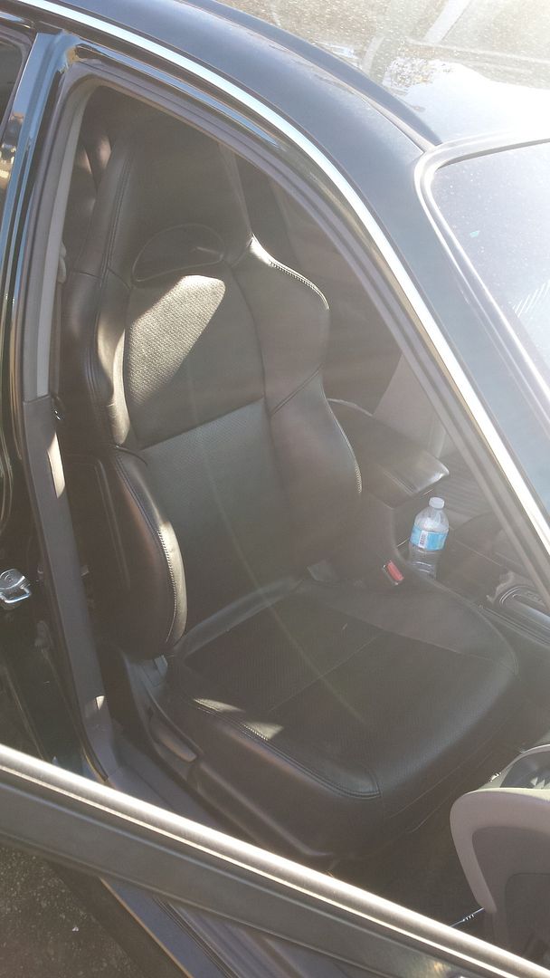

I know this has been done before but from what I've seen it was not completed (the post I mean), well I'm going all the way with this one. I read a lot before buying these seats about how they sit high in the sedans, I wasn't down with that. I didn't want to look like Andre The Giant driving in my Accord, so after a bit of drinking this is what I came up with.
I was hoping to do this with out welding just because me and most people don't have welders but unfortunately that didn't work out.
So far I have only done the passenger seat due to the drivers seat having the stitching coming out which my buddy's fixing for a hundie.
At this present time I have not done the left rear mount...Yet I will post it asap.
These are the seats I picked up car had 130 xxx on it so they are in real nice shape aside from the stitching coming out from drivers seat. I paid 200 Canadian
So first step remove the seat 4 14mm bolts then throw it out, burn it or whatever turns your crank.
I drilled out the factory (front) mounts, needed some help with a dermal also.
After that is done I swapped them on the opposite sides and bolted them int front mounts.
for the rear mount on the right side I found when you bolted it in the original hole the seat sat to far to the right. I re drilled the hole and used the dermal to make the bolt fit (had to grind down the washer and a little bit of the mount but now it sits perfectly.
Now back to the fronts now they somewhat line up so I clamped them with vice grips and off to an exhaust shop to get them tacked after that I will remove the seat and get it properly welded then grind them down nice and paint them so they don't rust
Here is what it looks like you can see it sits perfectly level with the drivers seat.
Sorry if the pics suck they are cell pics I will take a few more to show fitment and height but I had to go house boss was going crazy

I also just noticed that the seat belt buckle no longer fits anyone have a solution. The accord is a 98 seats are from an 03
I forgot 98 has no airbag in seat or any 6th gen?

Got the front mounts welded and primed, bought myself a little wire feed welder. I took the rear left side mount off the RSX seat and also the oem accord seat what I will do is fit the oem mount to the RSX seat. The reason I used the oem mount (instead of making a custom one) is so I can use the oem plastic cover on the mount.
Anybody have any input on the seat belts not working did they change the buckles from 98 to 01 in the Accords or are they the same any info would be cool

So for the seatbelts I took them from an 05 Acura EL they bolt in and they are black. I have the passenger side completed, I will post pics of all the brackets and how the seat sits tomorrow.

Seat is done and in with working seatbelt I, the rear right mount I temporarily made from scrap until I get the driver seat in then Ill make 2 better mounts but for now they hold a 245 lb person no problem
