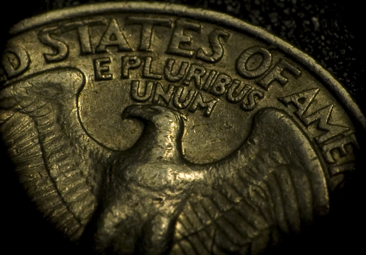

WHY: So I've been wanting to try taking macro pictures for some time but didn't want to spend the money on a real macro lens.
HOW: Sense I own 2 lenses I was able to attach one to the camera and hold the second one backwards up against the first lens while holding the aperture lever wide open. (You can buy rings to attach the front ends of two lenses together but I just used my UV Filters to protect each lens). You also need A LOT of light
EQUIPMENT:
-Nikon D90 @ ISO 1000, Metering Selector set to "spot" (center dot only), "program mode"
-Nikkor AF-S 35mm DX f/1.8
-Nikkor AF 70-210mm f/4 (constant) (full-frame lens)
-Desk lamp within appox 6" of subject
1st SETUP: I attached the 35mm to the camera, and left auto focus on. The second lens was set at 70mm and its aperture was held wide open. I held the camera as close to the objects as possible. *The following pictures were cropped and are shown 1x resolution*
1. Quarter

THOUGHTS: The eyes were the hardest to take and as you can see there's a lot of glare.
