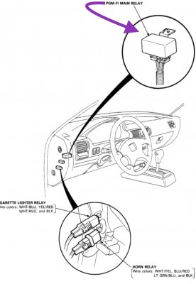

I wouldn’t swap the motor just yet. I would have a good, honest independent mechanic look into the Main Relay Switch. You can do it yourself by looking (see attached)

I concur on main relay switch. I had the same symptom. A replacement is under $50 shipped - however flowing the pcb with some good no-clean flux and re flowing the solder points did the trick for <$0.50 & 30 minutes.

Try turning your engine over by hand if you think it is seized. Tow truck drivers aren't mechanics. If you can turn the engine over by hand then it is not seized. If you turn the key and nothing happens, check the main relay as others have mentioned. You can remove the top of the relay to inspect the solder points, if the solder points are cracked, then either re-solder them or replace the relay.
