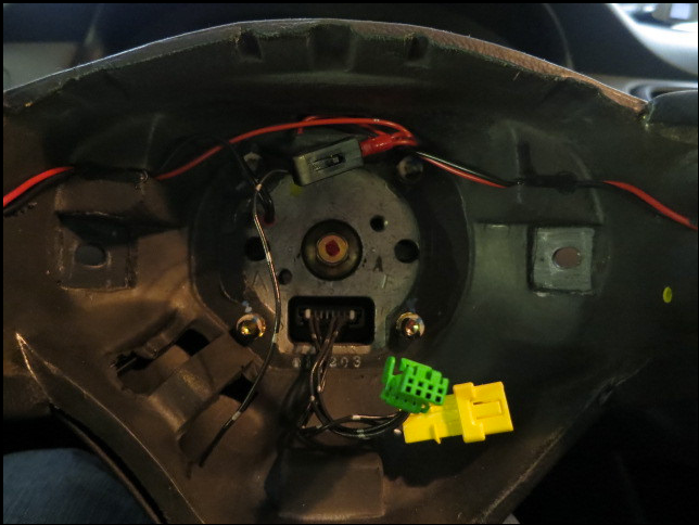

Hi everyone,
I had just installed a Euro-R steering wheel on to my sedan. Took it for a drive, feels great, but one thing that kinda bothers me is that the SRS light stays on. My Euro-R steering wheel did not come with Airbag module, so basically inside the steering wheel there is only one cable with black connector, I assume that this is for horn. On the other hand, the stock has a yellow and green connector, yellow is SRS and green is Cruise control. How can I get rid of the SRS light that stays on all the time?. Thanks in advance

It does not have the connection for SRS (the yellow plug) like our OEM steering wheel do.

Here's a pic of the inside of the steering wheel. Thanks
