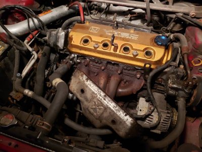

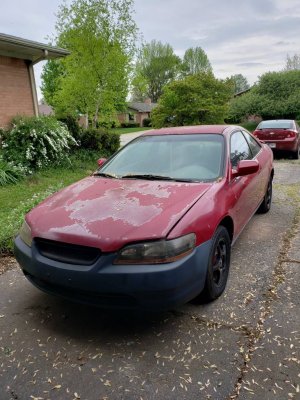

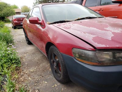

So, 5 years later and I'm back to work on the accord again. As with everything life got in the way. Got married and had a son last year so time is limited.
Over the last few weeks been working on her for an hour or 2 when I get home from work at 3am.
She has been sitting for quite some time and the clear coat has failed bad on the roof and hood along with some other parts of the car.
As stated before just want her up and running to use as a daily driver at times so no biggie.

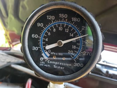

First I ran a compression test to see if it was even worth doing any work. Cylinders 1,2,and 4 were at 210. Cylinder 3 was 225. So really great for an engine with the miles this on has.

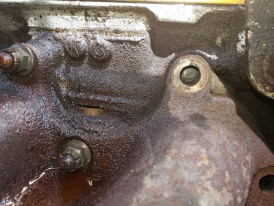

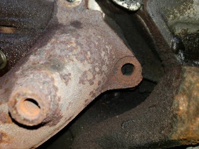

I believe the exhaust leak is from the stock flex pipe. So my next mission was to remove the exhaust manifold. During the process I discovered that I apparently had been missing one of the bolts that held the manifold on behind the alt. Then the one above it snapped while removing it. So two studs broke off in the head.
I had thought about removing the whole head previously to go through it, but after the compression test I was just thinking maybe I'd just leave it on and do the "rope down the sparkplug hole" trick to change the valve seals seeing as I have no compressor. At this point I'm thinking I may remove it again if I can't get these broken studs out.
I have never removed a cylinder head before but I am not scarred to try. Idk guess I'll figure it out. Also, here are those pictures I promised 5 years ago. 20210502_173249.jpg20210502_173303.jpg20210520_123603.jpg20210516_011945.jpg

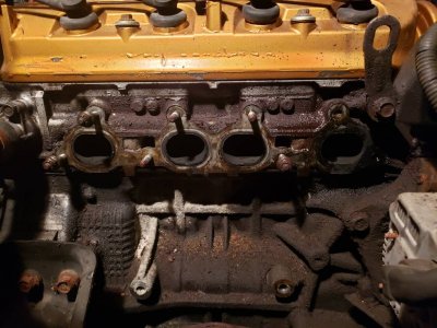

Last night I got the top part of the manifold removed. Here is a shot of the front of the head without the mani.20210523_234600.jpg
