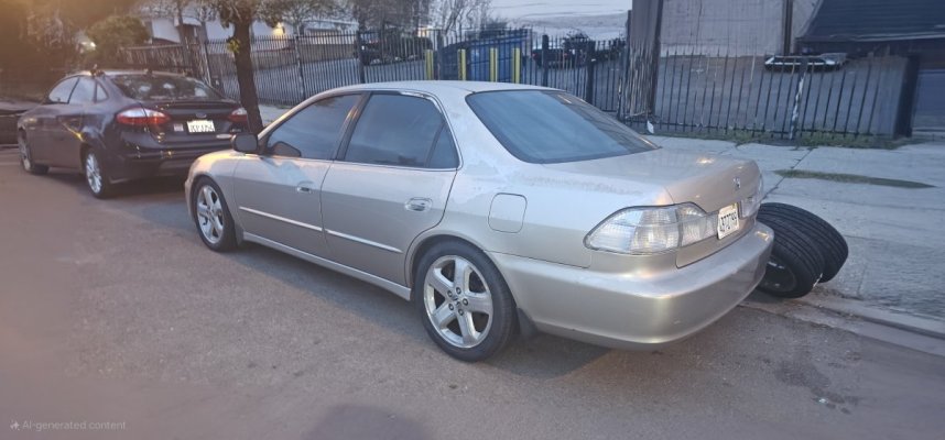

currently running Type S TL "Fat 5's" - 225/45/17's with 25mm spacers on the rears and 15mm spacers for the fronts. no rubbing. im also on TEIN Flex Z's
_S0NiC_
New Member
Jun 28, 2021
Los Angeles
forgot to attach the pictures for the 17" wheels.
