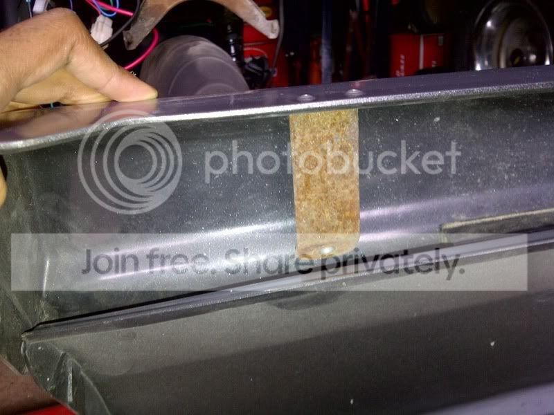

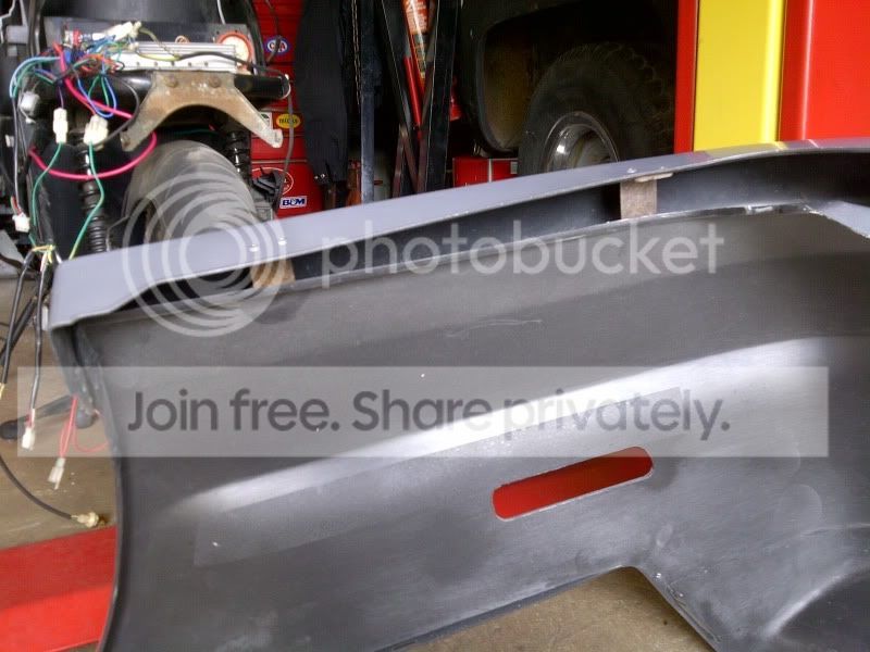

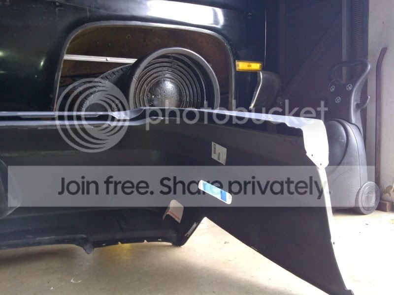

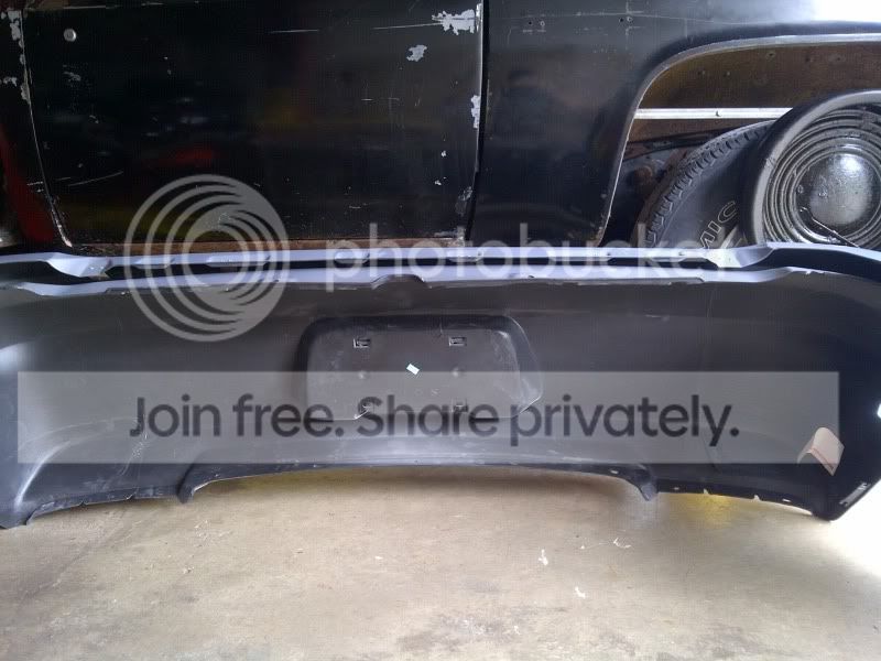

I bought a 98 rear bumper (aftermarket) and got it painted. The rear lip mounts fine, but I have no idea where the tabs mount to...Anyone with an oem rear lip help me? I have pictures of what I'm trying to explain.

There's a template from Honda that you put on the bumper so you know where to drill the holes.

There is a template that is made of paper where you line it up on the inside of the rear bumper and drill holes. There is no way to mount that to your car securely without the template really. Kind of sucks that the design requires you to put holes into your bumper but the plus side is that it'll be virtually impossible to have the lip stolen. The parts department should have it.

Yeah I never knew about it until I did the 98-00 rear bumper conversion and the body shop had no idea how to mount the lip. Luckily I had access to the template though.
