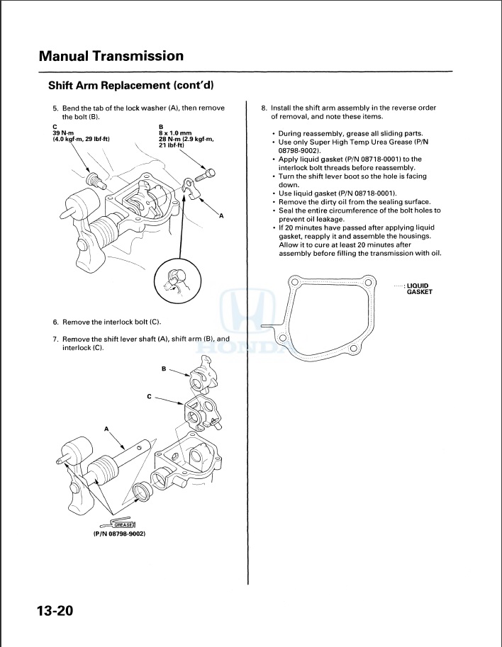

    Hi guys, I've had a slow MT fluid leak dripping off the bottom of the transmission for some time now. I finally traced it to the top of the transmission where the shift arm cover is located.
    I'm looking to replace the oil seals but wanted to get a heads up on how complicated it is to change it out on my own. I haven't found any resources online on how to go about replacing it. Due to the wetness in this area, I believed the leak I have is coming out of one or two places in the area. (#14 and #15 of the diagram below).
    https://www.hondapartsnow.com/parts...-ka_5mt/transmission_manual/mt_shift_arm.html
    Does anyone have any tips on replacing these seals? Is there a sequence on what needs to be removed to get to that seal?
    Any help is much appreciated.

    This is what you are looking for:
    [​IMG]
    [​IMG]
    [​IMG]

    This is perfect! Thank so much!
