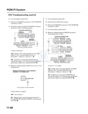

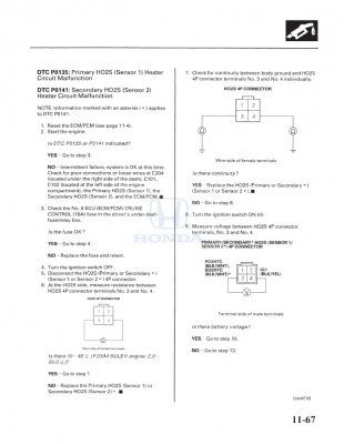

Hello!
I have a 2001 LX Sedan with an f23 A1
I have multiple cel codes that point to a short to ground somewhere as the root of all these codes. I just don't know where to start.
I need to get it to pass smog in eight days or I'll be without a car. At first it was just throwing a code for the o2 sensor so I replaced it but now there's four codes and they all seem related. I just don't know where to begin. Maybe you can point me in the right direction.
These are all the codes:
OBD2
DTC report
Selected brand: Honda
============1==============
P0141
Raw code: 0141
ECU: 0D
Status: Confirmed
OBDII: Heated oxygen sensor (HO2S) 2, bank 1, heater control - circuit malfunction
Honda: Secondary Heated Oxygen Sensor (Secondary HO2S) (Sensor 2) Heater Circuit Malfunction
============2==============
P1164
Raw code: 1164
ECU: 0D
Status: Confirmed
Honda: Air/Fuel Ratio (AF) Sensor (Sensor 1) Circuit Range/Performance; Air / Fuel Ratio (A/F) Sensor (Sensor 1) Range / Performance Problem A/F sensor,or Air / Fuel Ratio (AF) Sensor (Sensor 1) Circuit Range / Performance A/F sensor
============3==============
P1162
Raw code: 1162
ECU: 0D
Status: Confirmed
OBDII: Fuel Temp. Sensor Circ. Short to Ground
Honda: Air/Fuel Ratio (A/F) Sensor (Sensor 1) Slow Response; Air / Fuel Ratio (A/F) Sensor (Sensor 1) Slow Response A/F sensor
============4==============
P1166
Raw code: 1166
ECU: 0D
Status: Confirmed
OBDII: Air / Fuel Ratio (A/F) Sensor (Sensor 1) Heater System Electrical Problem A/F sensor heater,or Heated Oxgen Sensor Sensor1 (Primary HO2S) Heater Circuit Malfunction (HO2S)
Honda: Heated Oxgen Sensor Sensor1 (Primary HO2S) Heater Circuit Malfunction
I feel like these are all related to some kind you f electrical issue. But I could be completely off.
Any suggestions on where to begin?
I don't want to just start throwing parts at it I want to figure this out before my registration expires. I need this car for work and I'm starting to freak out a little.
