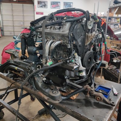

New OEM Parts Replacement Log:
-- 12/01/2008 099,070 mi Exterior Light Bulb(s)
-- 02/01/2010 107,884 mi Engine / Powertrain Computer / Module
-- 03/04/2010 108,279 mi Water Pump & Timing Belt
-- 06/16/2012 120,849 mi Battery & Light Bulbs
-- 01/21/2015 ***,*** mi Rear Brake Calipers
-- 06/23/2015 133,467 mi Front and Rear Brake Pads
-- 06/23/2015 133,467 mi Front Calipers
-- 06/23/2015 133,467 mi Rear Rotors
-- 12/12/2015 135,520 mi Heater Control Valve
-- 07/16/2020 143,453 mi New Owner ---------- Me!!!
-- 07/27/2020 143,460 mi Fuel Pump Relay
-- 08/26/2020 143,481 mi EGR Valve
-- 08/18/2020 143,483 mi Ignition Coils (Aftermarket) (Retired)
-- 08/18/2020 143,483 mi Spark Plugs & Wheel Studs
-- 12/09/2020 144,476 mi Air Intake (Aftermarket)
-- 12/09/2020 144,476 mi Intake Manifold
-- 12/09/2020 144,476 mi Intake Manifold Top Cover
-- 12/09/2020 144,476 mi Throttle Body Gaskets
-- 12/09/2020 144,476 mi Throttle Position Sensor Gasket
-- 12/10/2020 144,476 mi Rear Brake Rotors and Pads
-- 12/18/2020 144,476 mi Rear Wheel Bearings and Hubs
-- 12/18/2020 144,476 mi Parking Brake Hardware Kit
-- 01/18/2021 144,506 mi Front Valve Cover
-- 01/18/2021 144,506 mi Intake Manifold Cover Bracket
-- 01/18/2021 144,506 mi Lower Plenum Gasket
-- 01/18/2021 144,506 mi Oil Pan Gasket
-- 01/18/2021 144,506 mi Spark Plug Tube Seals
-- 01/18/2021 144,506 mi Valve Cover Gaskets
-- 01/18/2021 144,506 mi Valve Cover Seal Washers
-- 03/04/2021 144,944 mi Front Upper Ball Joint (Aftermarket)
-- 09/27/2021 148,479 mi A/C belt
-- 09/27/2021 148,479 mi Camshaft Seal
-- 09/27/2021 148,479 mi Crankshaft Seals
-- 09/27/2021 148,479 mi Drive Belt
-- 09/27/2021 148,479 mi Drive Belt Tensioner
-- 09/27/2021 148,479 mi Fuel Injectors
-- 09/27/2021 148,479 mi Idler Bearing
-- 09/27/2021 148,479 mi Oil Pressure Switch
-- 09/27/2021 148,479 mi Power Steering Pump
-- 09/27/2021 148,479 mi Power Steering Pump Belt
-- 09/27/2021 148,479 mi Spool Valve Filter Housing
-- 09/27/2021 148,479 mi Tensioner Bearing
-- 09/27/2021 148,479 mi Timing Belt
-- 09/27/2021 148,479 mi Water Pump
-- 09/27/2021 148,479 mi Water Temperature Sensor
-- 10/03/2022 149,282 mi Clutch (Aftermarket)
-- 10/03/2022 149,282 mi Flywheel (Aftermarket)
-- 10/03/2022 149,282 mi Motor Mounts (Fr & Rr Aftermarket)
-- 10/03/2022 149,282 mi Motor Mount Brackets
-- 10/03/2022 149,282 mi Transmission Mount Components
-- 10/03/2022 149,282 mi Cylinder Head Bolts
-- 10/03/2022 149,282 mi Camshaft Thrust Covers
-- 10/03/2022 149,282 mi Thermostat Sensor Switch O-ring
-- 10/03/2022 149,282 mi Head Gaskets
-- 10/03/2022 149,282 mi Intake Manifold Plenum Gaskets
-- 10/03/2022 149,282 mi Spark Plugs
-- 10/03/2022 149,282 mi Fuel Rails + Sealing Components
-- 10/03/2022 149,282 mi Injector Base Gaskets
-- 10/03/2022 149,282 mi Starter
-- 10/03/2022 149,282 mi Alternator (Aftermarket)
-- 10/03/2022 149,282 mi A/C Compressor (Used - My Accord's)
-- 10/03/2022 149,282 mi Crankshaft Pulley
-- 10/03/2022 149,282 mi Exhausts Manifold Headers & A-pipe (Aftermarket)
-- 10/03/2022 149,282 mi Exhausts Manifold Gaskets (Aftermarket)
-- 10/03/2022 149,282 mi Oil Pan with Honda-Bond Sealing
-- 10/03/2022 149,282 mi Oil Pump Front Main Oil Seal
-- 10/03/2022 149,282 mi Cylinder Block Rear Main Oil Seal & Plate
-- 10/03/2022 149,282 mi Catalytic Converter (Aftermarket)
-- 10/03/2022 149,282 mi Cat-Back Exhausts System (Aftermarket)
-- 10/03/2022 149,282 mi Exhausts Hangers
-- 10/03/2022 149,282 mi Power Steering Rack (Aftermarket)
-- 10/03/2022 149,282 mi Outer Tie Rod Ends (Aftermarket)
-- 01/12/2023 150,081 mi Passenger Motor Mount
-- 01/12/2023 150,081 mi Valve Cover Seal Washers
-- 01/12/2023 150,081 mi Upper & Lower radiator Hoses
-- 05/25/2023 156,699 mi Tires (2 Used, 2 New)
-- 06/22/2023 157,665 mi Rear Left Brake Caliper
-- 06/22/2023 157,665 mi Rear Brake Pads
-- 06/29/2023 158,003 mi Driver's Side HID Ballast (Used)
-- 07/13/2023 158,191 mi Thermostat, Switch, & the Cover
-- 11/07/2023 161,788 mi Drive Shafts
-- 11/07/2023 161,788 mi Half Shaft Assembly Components
-- 02/05/2024 164,922 mi Clutch Master Cylinder
-- 02/05/2024 164,922 mi Clutch Slave Cylinder
-- 02/05/2024 164,922 mi Clutch Line (Aftermarket)
-- 02/05/2024 164,922 mi Radiator (Aftermarket)
-- 02/05/2024 164,922 mi Radiator Upper Hose Clamp
-- 02/16/2024 165,500 mi Battery (Aftermarket)
-- 02/24/2024 165,650 mi Radiator Holders (Used - My Accord's)
-- 02/24/2024 165,650 mi Wheel Lug Nuts (Used - My Accord's)
-- 03/24/2024 167,030 mi Fuel Filler Cap (Used - My Accord's)
-- 03/24/2024 167,030 mi Wheel Center Caps
-- 03/30/2024 167,100 mi Sub Ground Wire
-- 07/09/2024 170,054 mi Ignition Coils
-- 05/29/2025 180,010 mi Brake Fluid Reservoir Tank Cap
-- 07/07/2025 181,093 mi Valve Cover Gaskets
-- 07/07/2025 181,093 mi Upper & Lower Intake Plenum Gaskets

-- 07/09/2024 170,054 mi Engine Oil Changed
-- 08/07/2024 170,650 mi Front Bumper Cover's Dent Removed
-- 08/11/2024 170,700 mi Engine Hood Liner Removed
-- 08/11/2024 170,700 mi Driver's side Windshield Washer Sprayer Fixed
-- 08/19/2024 170,800 mi Engine Bay Water Proofed
-- 08/24/2024 171,200 mi Cabin Air Filters Changed
-- 08/24/2024 171,200 mi Cabin Air Filter Compartment Cleaned
-- 08/30/2024 171,301 mi Head Unit CD Changer Fixed
-- 08/30/2024 171,301 mi Dash & Console Assemblies Cleaned
-- 09/22/2024 171,717 mi Power Steering Supply Line Polished
-- 03/24/2025 177,778 mi Engine Oil Changed
-- 05/29/2025 180,010 mi Engine Wire Harness Brackets Rust Removed
-- 07/07/2025 181,093 mi Valve Clearance Adjusted
-- 07/07/2025 181,093 mi Fuel Induction Clean Serviced
-- 07/07/2025 181,093 mi Engine Oil Changed
Vehicle Condition Remarks: (As of 07/07/2025)
-- Brake Fluid ----- Due Soon
-- Alternator Belt ----- Brown / Dry looking
-- Rear Window Film ----- Bubbled.
-- Front Brake Rotors ----- Warped.
-- Struts ----- Weak.
-- RSB Mount Bushings & End links ----- Shot.
-- Front Floor Under Seat ----- Crushed lol.
Parts to be extracted during the swap:
– Motor & Transmission + Mounts
– Engine Wire Harness + Brackets
– ECU
– Drive Axles + Half Shaft
– Power Steering Rack
– Cruise Control Unit
– Shift Cables + Shift Box (Latter needs replacement)
– Brake Pedal
– Clutch Pedal
– Clutch Pedal Mounting Box
– Clutch Fluid Tank + Bracket (Latter needs replacement)
– Clutch Slave & Master Cylinder
– Clutch Line
– Rear Brake Caliper(s)
– Fuse Box
– Security System Brain
– Keys & Remotes
– Side Mirrors
– Bose Tweeters & Amplifier
Accord parts to be reused during the swap:
– A/C Compressor
– Battery Box
– Condenser
– Denso Odyssey Alternator
– Engine Mounting Bracket
– Idle Air Control Valve & Gasket
– Power Steering Oil Hose
– Throttle Cable
– Zero Gauge Ground Wires
Accord parts to be saved after the swap:
– Air Intake
– Catalytic Converter
– Exhaust Hanger Mounts
– Radiator & Hoses
– Rear Cylinder Head Cover
– Thermostat
– Y-pipe & Mufflers
Biography:
2003 3.2CL Type-S 6MT Non-Nav San Marino Pink, I mean, Red. This thing is actually a donor car for my Accord to get the J32 & 6MT swap upgrade done. The car was a little rusty and banged up, with the mileage being relatively high, but I bought this because it had such a clean tittle and service history, even though the car was driven by 2 owners. Honestly, I didn't know how rare these 6MT CLs were, until I really began searching for one, when my Accord's AT started to fail in '19. As the matter of fact, only 3479 units with 6MT were produced exclusively in 2003. Also, only 146 of those were available in red exterior with black interior. How rare is that!? As of now, the restoration process is about 90% completed. It's been a longer journey than the original plan I had in my mind, when I got this car in 2020, but she has become a solid daily beater now, and a very fun car to drive after all. It's been nice to go out and park anywhere without having any concerns. My Accord has been able to get some rest, from time to time, until the swap happens in the future. Thanks for looking!
Performance / Engine Bay:
* BOSCH Icon Wiper Blades
* DC SPORTS 2G CL Auto / 6G Accord V6 SS Exhaust Headers
* DENSO Alternator
* EXEDY OEM Spec Clutch
* INJEN Hydro-Shield Air Intake Filter Cover
* INJEN Polished Cold Air Intake
* INNOVATIVE OEM Spec Motor Mounts (Fr & Rr, Mod to clear DC Header)
* INTERSTATE Battery
* JDM Wind Noise-Reducing Engine Hood Weather Strips (As waterproof)
* KOYO OEM Spec Radiator
* MAGNAFLOW OEM Spec Catalytic Converter
* MOBIL 1 Advanced Full Synthetic 5W-20 Engine Oil
* MOBIL 1 Extended Performance Oil Filter
* OEM Clutch Slave Cylinder Delay Valve Deleted
* OEM Engine Hood Liner Deleted
* OEM Sub Ground Wire Cable Waterproofed
* OEM+ 1G TSX / 3G TL / 7G Accord V6 / RSX Clutch Master Cylinder
* OEM+ 3G TL Base 6MT / 7G Accord V6 6MT Starter Motor
* OEM+ 4G TL SH-AWD J37A4 70mm Inlet Intake Manifold
* OEM+ 8G Accord V6 Auto J35Z2 Intake Manifold Top Cover
* P2R OEM J32 68mm TB to OEM+ J37 70mm IM Adaptor / Spacer
* P2R Steel Braided Clutch Line
* RAIN-X All Season Windshield Washer Fluid
* REVEL by TANABE Medallion Touring-S SS Cat-Back Exhausts System
* SCHAEFFLER by LUK OEM Spec Dual Mass Flywheel
Suspension / Footwork:
* FALKEN Pro G5 All Season High Performance Tires (1 Pair)
* FALKEN Sincera SN250 All Season Grand-Touring Tires (1 Pair)
* Honda OEM+ 9G Accord Black Wheel Center Caps
* SPC OEM Spec Upper Ball Joint (Front Right)
* Unbranded Power Steering Rack w/ Endlinks
Exterior / Cosmetics:
* De-Badged 3.2CL Type-S Emblem (Fell Off Lol)
* OEM Optional Splash Guards
* OEM Optional Trunk Deck Spoiler
* Unbranded Weather-Strip (Windshield - Wiper Blades Cowl)
Interior:
* BROADWAY 320mm Flat Rear View Mirror
* CARZDELUXE DESIGNS 6G Accord Phone Holder
* CUSTOM ACCESSORIES Black Front Seat Covers
* JDM Black Front Seats Neck Rest Pillows by DAISO
* JDM Front Seats - Center Console Gap filling Cushion
* JDM Squash Scent Air Freshener by AIR SPENCER
* MEGUIAR'S New Car Scent Air Re-Fresher
* OSHACO Seat Belt Tension Adjuster
* Pre-Owned Rear Window Film (Bubbled & Purpled Lol)
* WEATHERTECH All-Weather Universal Floor Mats
Lighting:
* IKEA USB LED Spot Light (Arm Rest Compartment Power Outlet)
Electronics / I.C.E. / Misc.:
* IKEA USB Cables
* JDM USB Cigarette Socket Chargers by DAISO
Photos:
– ECU
– Brake Pedal
– Clutch Pedal
– Clutch Line
– Fuse Box
– Keys & Remotes
– Side Mirrors
– A/C Compressor
– Battery Box
– Condenser
– Throttle Cable
– Air Intake
– Radiator & Hoses
– Thermostat
– Y-pipe & Mufflers
