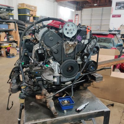

Got more new parts thrown into the motor. Oil Pan, crank pulley (couldn't resist with the old one), new(er) AC compressor from my Accord's spare. There will be a fresh n shiny set of the timing belt cover bolts as well.
Got my DC Sports headers modded to clear the rear MT mount. The piping is bent and the mount's arm is slightly scraped off to remain the clearance.
Took the transmission home so I could clean it out on my own. Took some elbow greasing but I think it became pretty decent now.
Got some parts for the clutch release fork, since they were pretty worn out. Once the MT is back on, the P.S. rack, cat converter, and the exhausts system will be on the go next.

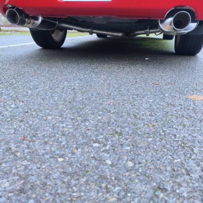

The car is almost getting ready to be picked up! Interestingly, they were unable to install my Innovative's RH passenger side engine motor mounts. I'll keep on rocking with the original mount until further notice, but whatever. I'll figure it out soon. The pre-owned HID ballast that I supplied didn't work out, so I still need to get another one, but from what I was reported, I'm confident that the car is coming back in an optimum level. He literally told me that I'll be pretty happy with the car's outcome. It's been a while since I felt so much excitement about my cars. I might need to start thinking about getting new(er) tires, before having too much fun with my old Pirellis going bad too soon.

Got the car back and drove it about a week. DAMN.., THIS CAR IS SO MUCH FUCKING FUN TO DRIVE.. Since I’ve been driving this thing like a grandma on a limp mode from day one, two years ago, I never have realized how this car could be such a beast. When it speeds up, that additional 60HP from the AV6 can definitely create more gravitational push. I think I know how 250HP feels like (on my Pilot lol), but it’s way quicker n pushier than that. Maybe I should appreciate the I.H.E upgrades + J37 IM setup for that. When entering on a highway, I feel like the car wants to accelerate forever until it reaches the redzone for the next gear, on each and every single gears.. The VTEC kicks in right before the 5K RPM, and it has a distinctively high toned, scratchy metallic sound like a jet engine on an airplane lol. It sounds way more different than how it comes out of my AV6’s roaring SRI. The new clutch feels solid and firm as well. It’s nice to be able to shift gears regardless of being at any RPM’s on any inclined roads. I forgot how fun rev matching was lol. (Can paddle shifters do rev matching these days btw?) Anyways, I was really underestimating how fun this car could be, compared to my AV6. My accord is definitely quicker on corners, but there’s no chance for it to beat this car haha. Now I know how this J32 feels like, and once again, I just can’t wait until I swap this thing into my Accord.

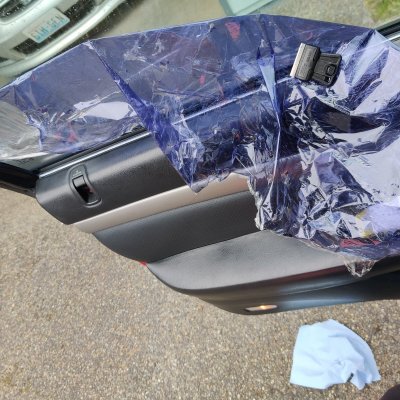

Got a pair of new Falkens to semi-match my old Falkens, and had the wheels aligned at the shop. Car's quieter, and more stable regardless of wet / dry road condition now. It's so much fun to feel the acceleration on any gears throughout all RPM range, even on the wet roads. :driving:
Found out that the window films on this car were poorly applied on top of the original window films lol. Went out to get this film adhesive remover spray, referred by my IG 6GA buddy, and removed the front side window sections with the razor blade that conveniently came with the spray. Was a bit worried about my level of the procedures at first, but it actually came out very clean, and it was a bit more fun and feeling kind of satisfying, rather than frustrating to remove them all lol. It's a bit of a fishbowl-looking up in the front now, but they're so much clear and easer to see the outside world. Way better than the blurry and scratchy views of the aged purple tints, I mean, window films. :emotions34:

* Tanabe Revel Medallion Touring-S Cat-Back Exhausts System
