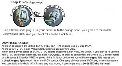

    Is this a true copied post about 2 wire to 3 wire IACV?
    People on the internet including some big name companies say you have to repin this and swap manifolds to use a 2 wire iacv. This is FALSE. You can run a 3 wire obd2 iacv with an obd1 ecu. I am currently using a p28 obd1 ecu with an obd2 F20b and my drivability issues went away as soon as I connected this.
    The process is so painstakingly obvious I can’t believe I didn’t realize this before. I have actually facepalmed myself for not taking an analytical look at this before. So here goes.
    Basically you find whatever pin your ecu has for iacv and connect that to the black and blue wire on your 3 wire obd2 iacv pigtail. Then you connect the black and yellow wire on the pigtail to any other 12 volt black and yellow wire you can get your hands on. Then you just take the black wire on the pigtail and ground it. That’s it. That’s all there is to it. So to reiterate for anyone who cares
    Ecu/chassis side. Iacv pigtail side
    iacv pin —————> black and blue on pigtail
    Blk/ylw 12 v wire—> blk/ylw on iacv plug
    Ground wire———> blk wire on pigtail."

    You liked it, but does that actually work? These clips are from other threads around the net. Like 50/50 some say you can now.
    My thoughts were perhaps, there was NEW a pluggin for crome or update for hondata , that allows 3+ wire IACV's.
    In the Accord, I used a 3 to 2 wire adapter because the Hondata does NOT control the 3 wire. The control signal is different. However a Pluggin or software update could change that . Remember Megasquirt? Megasquirt you could select the # of wires for the IacV and their operation. Was just software.
    It IS possible to wire a 3 wire into a 2 wire harness. That is not going to solve the issue with the stock 28P ECU.
