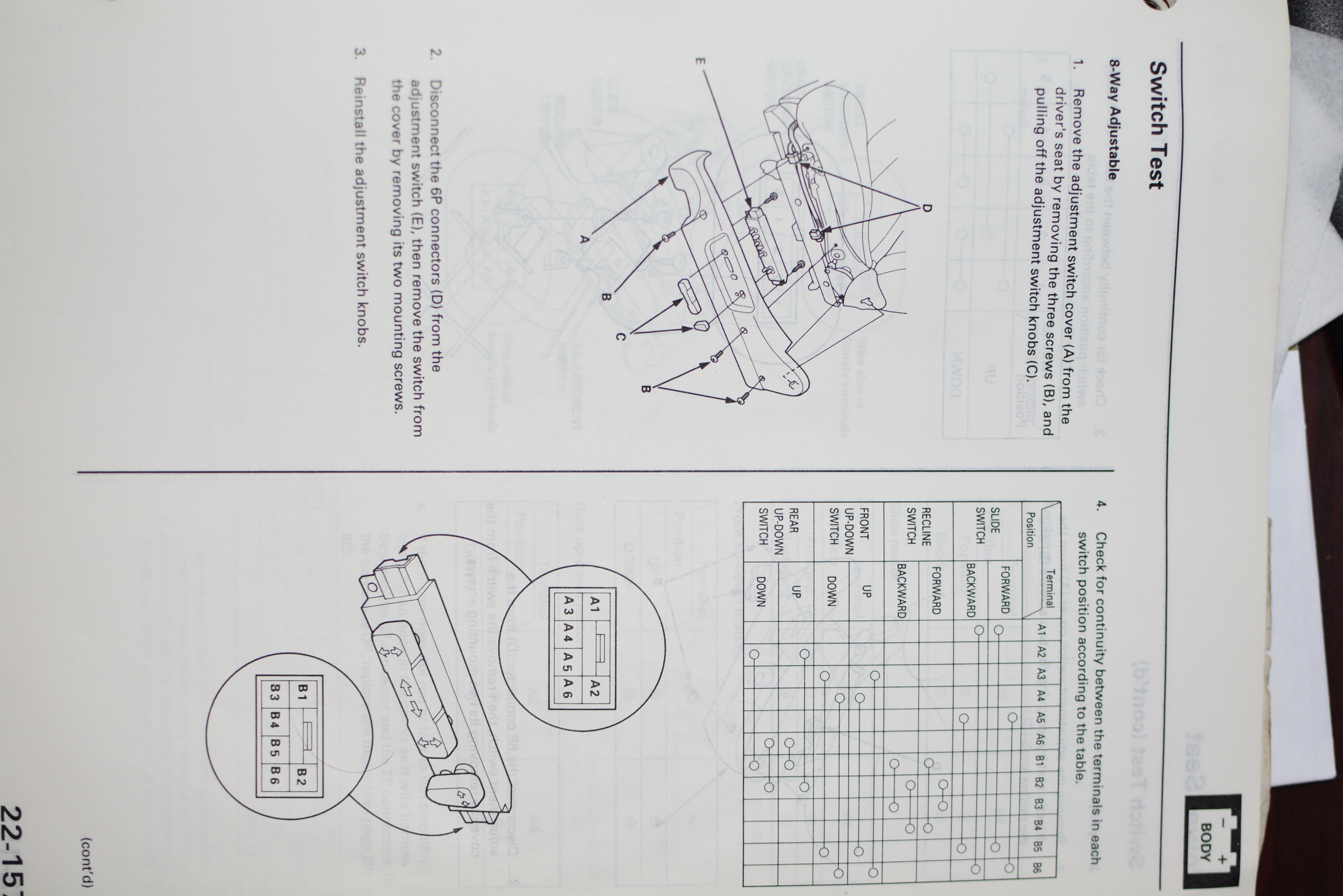

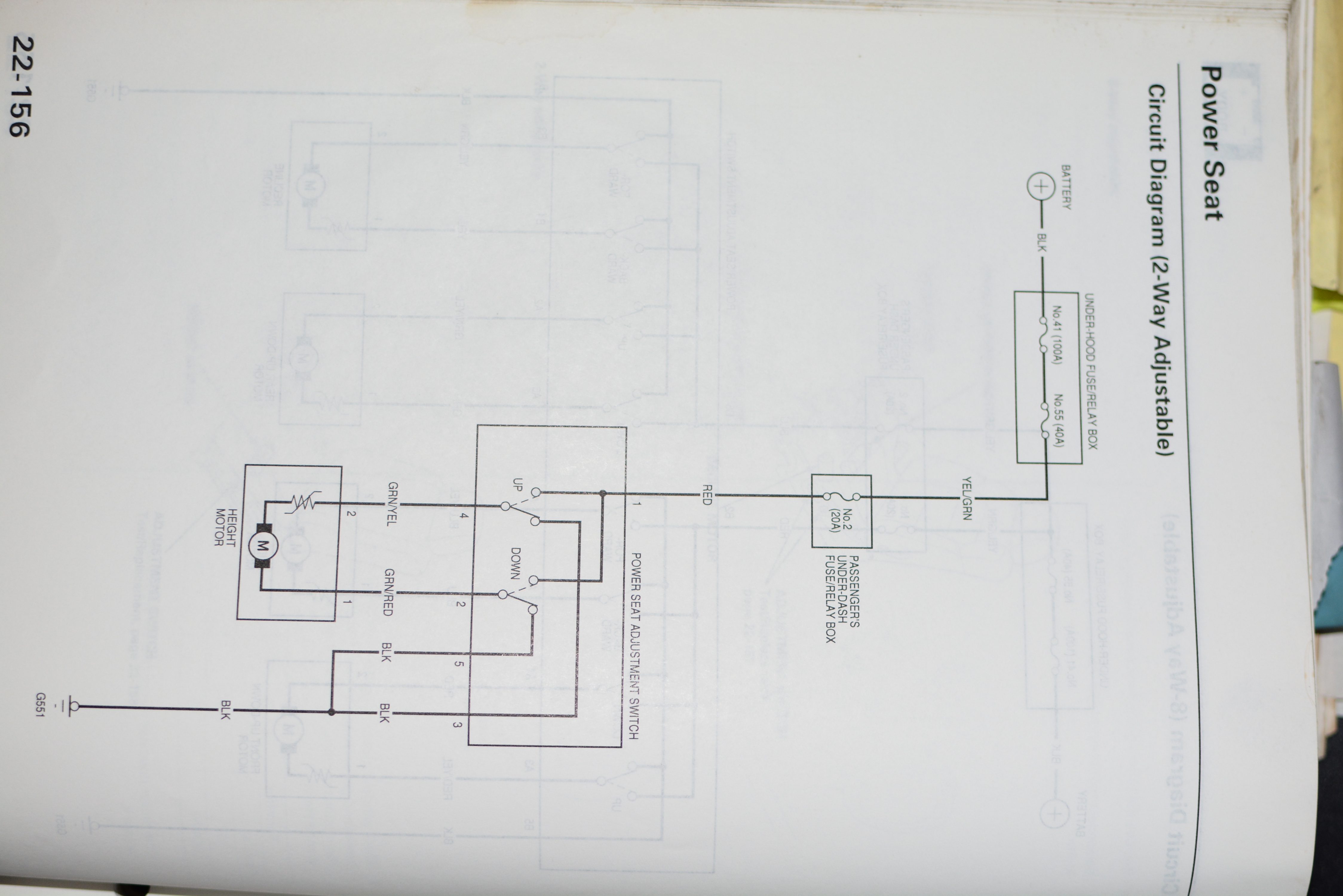

For anyone swapping in Acura CL seats, these diagrams should be useful. Pulled from a 98 accord manual. Sorry, I don't have CL information yet
**I dunno why all the photos are sideways. I'll fix it later
DSC_2553 by Jonathan Boothe, on Flickr
DSC_2554 by Jonathan Boothe, on Flickr
DSC_2555 by Jonathan Boothe, on Flickr
DSC_2556 by Jonathan Boothe, on Flickr
DSC_2557 by Jonathan Boothe, on Flickr
DSC_2558 by Jonathan Boothe, on Flickr
DSC_2559 by Jonathan Boothe, on Flickr
If you have CL info feel free to post

Stickied. Another 6GA Canada diagram, may be redundant:
CL info, maybe someone has better quality versions of the bottom 3...
Repped. Btw I think those are for CL-S, someone said the wiring was different between CL base and Type-S. Not sure if that’s true.

so i parted out my car and my car seats are kind of just chilling in my living room.
i thought it'd be cool to rewire the seats to work off an external power source. i don't see the specifications describing the wiring down to the resistances, etc. any suggestions??

blu/red = power
blu/wht = ground
for driver seat, of accord, for RECLINE only, switch still works.

Do the us models accord have it prewired and we just have to supply with switches like the 01 gs300 did or do we have to completely wire the seats with fuses and such?

no it's not prewired. You'll have to add all the wiring
