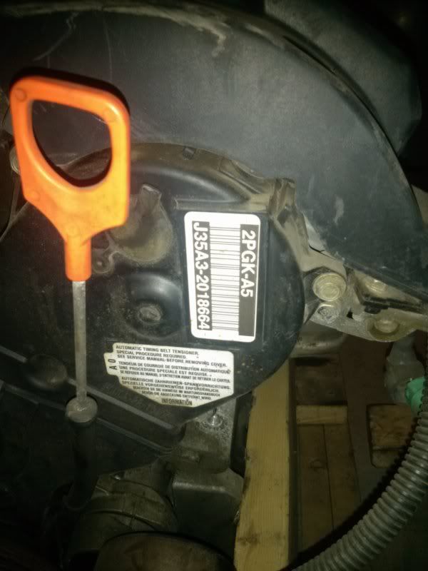

Well, as per my sig, I have officially purchased my J35(02 MDX) and Tranny(05 Oddy). Yes, I am keeping it auto for now, but there will be updates to come on that in due time.
I will update this thread with pics and a parts list.

Finally, some pics.
The Bzns
