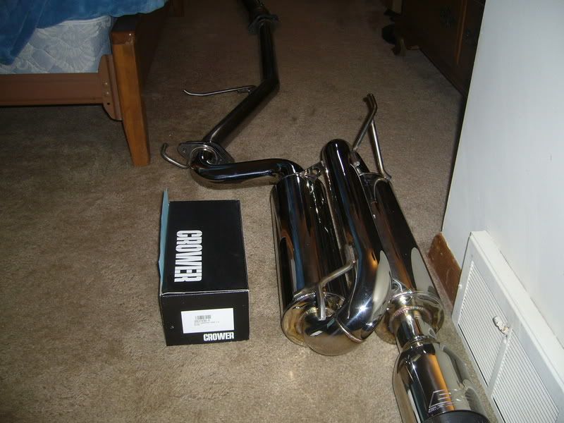

Brand & model: Greddy Dual EVO Full Cat-Back exhaust
Price paid and from where: $300 Local. (Used)
Pros: Mid & High end will dramatically increase. Subtle exhaust note, not loud, very low drone.
Cons: HUGE CANS. Will lose low end if there is no tuning.
Final verdict: They are big and you might not like them if you don't have a big body kit. Putting these with a lip kit or a no lip might make your car have two big ol' rocket "fart cans". As for gains, great.

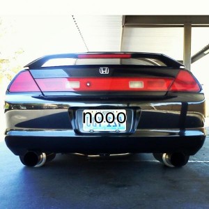

Aiming for Just a nice deep tone? not interestested in the $550+ catback system that will do nothing for you unless you do some other mods?
Brand & model: (V6) Magnaflow Universal Mufflers from hottexhaust.com
Price paid and from where: 2 @ $65.
Pros: Nice deep tone, removing the Pre muffler and resonator help deepen the tone.
Cons: need to have custom brackets made.
Final verdict: if all your looking for is the sound.. get that deep exhaust tone for a cheap price
OEM Piping, with Straight pipe replacing Pre-muffler and resonator. 2 universal 2.5" Magnaflow mufflers welded on after the Y pipe
