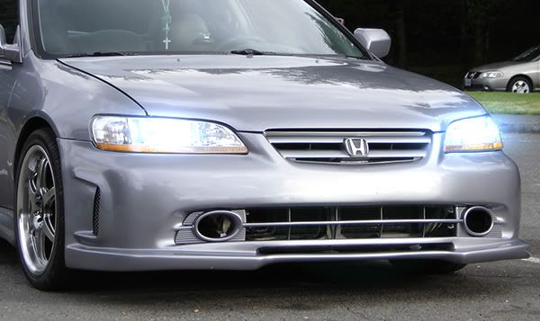

    Lights on:
    [​IMG]

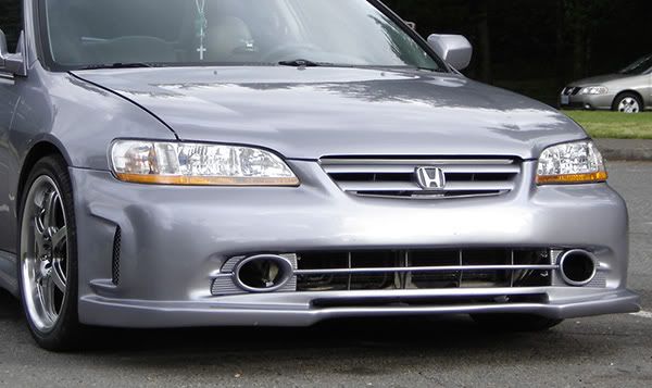

    Lights off:
    [​IMG]

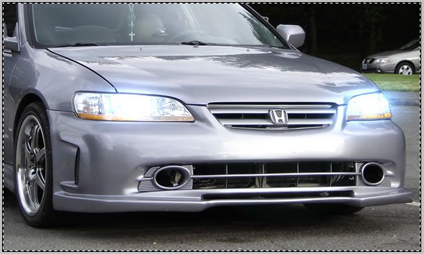

    2. Now with that now layer created, minimize your "lights off" image and bring up your "lights on" image. Now go to Select > All (Ctrl+A). Once the image has been selected copy it Edit > Copy (Ctrl+C).
    Should look like so once selected:
    [​IMG]

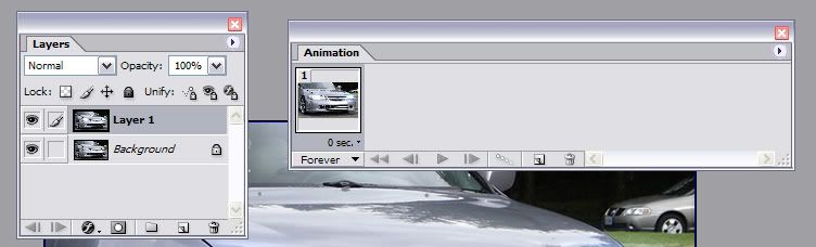

    5. Ok so you hit the magical button and image ready starts to open. Once it has fully opened you will notice the image you were just working on along with the layers has automatically imported into Imageready! Now lets get to work.
    6. You will be working with two main palettes here in Imageready the "Layers Palette" and the "Animation Palette" if you do not see these palettes when Imageready opens up go to Window and make sure "Animation" & "Layers" have a check by them,
    [​IMG]

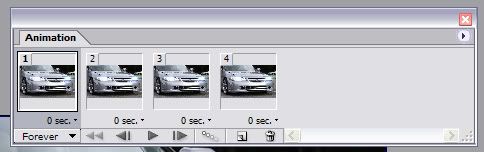

    7. Ok first thing is first. On the "animation palette" you will see a little icon allowing you to duplicate the current frame. Go ahead and hit that button 3 times. (you can add as many frames as you wish but I choose to keep it simple and use only 4)
    the button:
    [​IMG]
    what your frames should look like afterwards:
    [​IMG]

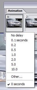

    9. Ok no that we have that layer hidden go back to your "Animation Palette" on the first frame you will notice "0 sec." at the bottom click on it. It will bring up a little menu. What this little menu does is gives you the option to select how much delay you want between this frame and the next frame. We're going to go ahead and pick 0.5 (half a second)
    [​IMG]

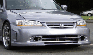

    13. So you checked out your animation and you like it. Now it's time to save it. Go to"File > Save Optimized As..." or "Ctrl+Shift+Alt+S". This will bring up a little window. Typical file saving dialog for windows but with a few extra options. All you need to worry about here is the "Save as type:" has "Image Only (*.gif)" selected. Then simple choose where you want to save it and the name you wish it to be saved as and hit "Save". Congrats you have just created your first animation. Here is my result below.
    [​IMG]
