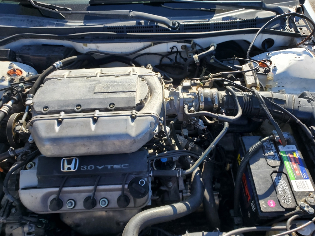

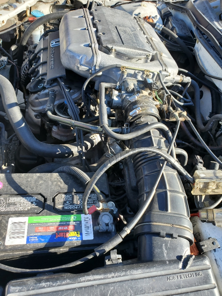

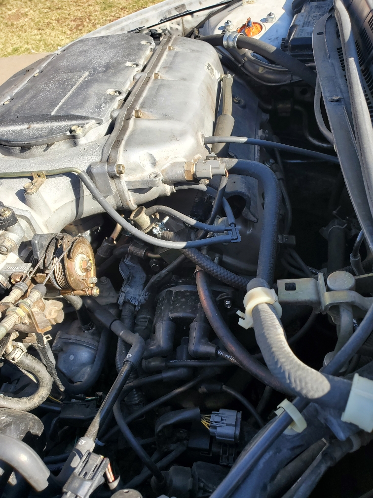

Have 99 accord 3.0 and put intake off of a 02 Honda Odyssey everything seems to be ok but gettin a misfire codes new plugs wires cap rotor valve cover modified the vacuum lines to make sure all lines are connected only thing haven't done was get it tuned would like coo know would that somethin I need to get done someone help plz also took to it to a couple import shops they say say everything is all good so some one plz help a brothah out

I know I'm a bit late. All three temp sensors: Intake, Coolant and Fan switch should be replaced. Especially if she doesn't like starting hot (within 20 minutes of turning engine off). This almost always throws multiple misfires and could be why shop says nothing wrong. I replaced all spark plugs and checked coils and it did not fix problem. The temp sensors did. Should be under $20.
