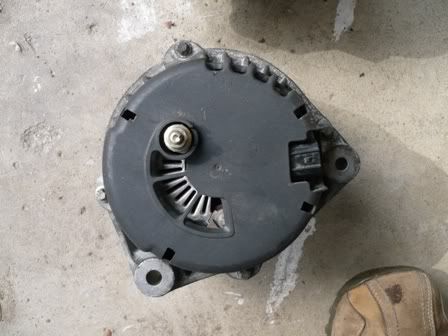

Ok so this is it. The top two photos shows the difference in configuration of the desno (odyssey)on the top and the delphi (accord) on the bottom. The main differences is that the delphi has the power connector on the top and the denso has it on the side about an inch away and the negative lead is moved closer to the top of the alternator giving more slack on the negative lead.

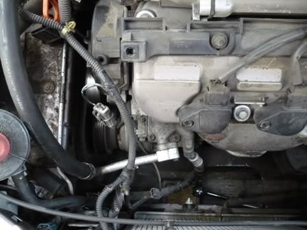

Before getting into it this photo shows the engine covers removed and what you will be starting with.
