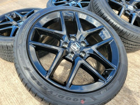

I'm highly interested in getting these wheels and installing them on Dirty Girl. Will these wheels fit or will there be fitment issues?
Does anyone know what the stock offset is on our 16" wheels? Does anyone know what the offset of the 11th Gen Civic wheels are?

Assuming your car originally had the 195/56-15 +55
The civic's are 235/40-18 +50

205/60-16, but I punched in those numbers. And yeah, it was one of these calculators I was using.
So, it looks like I might have exactly what I'm looking for with these 11th Gen Civic wheels?! Wheels tucked just inside or flush with the fenders, have no wheel run at all anywhere, run Honda OEM wheels, AND look sick AF all at the same time?!??

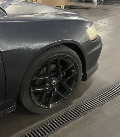

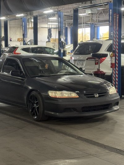

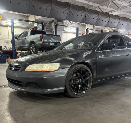

Hey do have a coupe or a sedan? I work at a dealership and have a 02 coupe. I could swap them off a car and take pictures if you’d like.
Shig
New Member
Aug 2, 2024
Arizona phx
Sorry it took so long. This is what they look like on my coupe. Not my taste tbh but it might look nice on an accord that’s lower and not clapped out looking . Tire size was 225/40 18. Didn’t seem to rub but I’m running Amazon springs.
