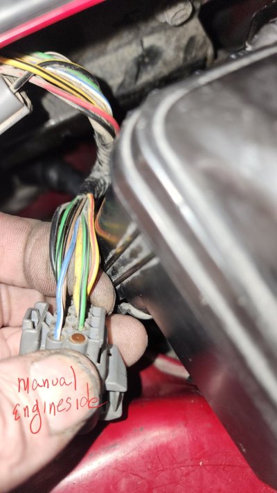

I’m pretty new to the forums but I’ve recently been hopping on this one and it’s been helpful. And now I need to know if when doing the manual swap for an 01 can you just swap out the ecu and engine harness to the manual cars to get it to work or do you still just have to rewrite everything.

What motor do you have? F23 or J30? I did my J32 6 speed swap last year and it's pretty much plug and play, minus rewiring one connector for the ecu if you have a Acura CL donor car.
