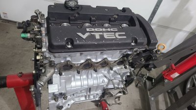

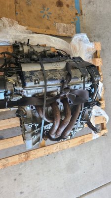

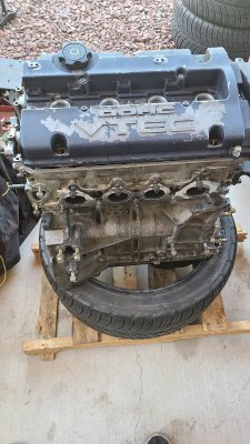

Hey Bense, like $1300 shipped. Wasnt that good of condition cosmetically. Lot of oxidation and some corrosion from salt air. last one i got was like $1100 in 2016, it was much better condition and came with a harness, ecu and alternator. Inflation and scarcity i guess. Here's a cleaned up pic. Didn't use the beat up blue valve cover.
H23 is mostly stock, except stage 1 skunk2 tuner cams and balance shaft delete kit. The h22 it replaced (2nd & 3rd pic) is sleeved, has forged rods, forged +1mm high compression pistons, skunk 2 valve train and stage 2 cams. But. i think it needs valve guides or stem seals replaced. Eventually I'll do something with it.
