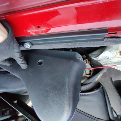

Recalled myself of searching for a solution at Acurazine once, and searched it again to refresh my memories of what I've remembered. 1st was to remove the plastic cover on the side of the seat, where the buttons are attached. (Had to remove the door sills first for the better clearance to access those two screws to detach the cover.) There was a gear mill trying to move by a bit, every time I press the recline button. 2nd was to shoot some greasing spray on the gear, and let it move with the help of my force with a flat head screw driver, as I was pressing the button. It struggled for a few seconds, and started to turn again... Yay! Worked on the other side, and the seized reclining seats game's over, once for all. (IDK why but some pics just randomly rotate themselves, when I attach my photos from my hardware, and I can't do anything to fix it..

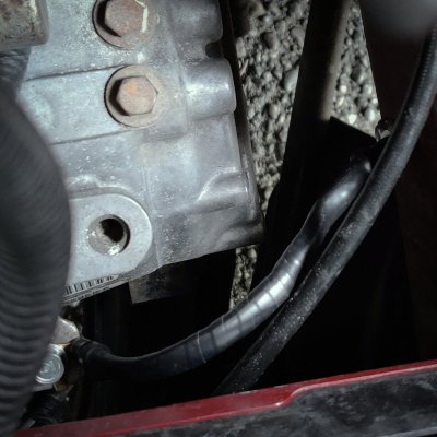

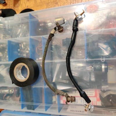

Been wanted to renew one of my ground cables, which has been bare naked and rusted. Was surprised to see how it doesn't come with any cover, since the Accord's seems to be somewhat covered. Hence, I added some heat-shrinking electrical tubes through the cable, and wrapped around the mid section with the electrical tape.
