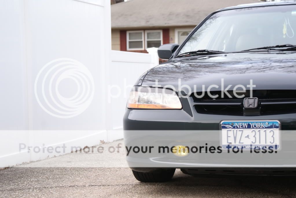

Quick question.
Dropped on Type 1's, and waiting for my camber kit to come in. I want my camber to obviously be as close a feasibly possible to 0.
Im running 17x7 or 7.5 (dont remember) +40 offset and im tucking right now, plan on raising my car up a bit in the back because if you look at the side skirt it gets lower as you go back which im not liking.
When I picture my rears with no camber, I can tell I will need to roll my fenders, but MY PROBLEM is the end of the bumper, the corner where is meets the fender. Will that rub? I'm nervous that I will. Heres a pick of how im dropped at the moment...

Quick question.
Are u getting front amd rear camber kits?? If not u should unless u gott $ to blow on tires..and u don't need to roll just trim the lip on the quarter panel that tab won't hit unless ur really slammed..and the fenders, just roll back the the fender liner tabs with ur hands I did and it worked.
