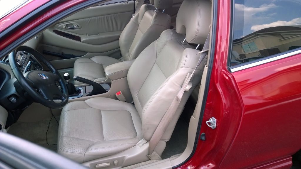

Originally Posted by RedRyder View Post
I highly recommend these seats, they bolt right in.
But do they wire right up? That's the important question, lol. How are you coming on that btw?

Define “wire right up”
Short story long: I don’t want to cut up/splice the seat harness plugs that hang from the seats, so I’ve been trying to find the other side of the seat harness or even just the pigtail for a 2003 (the plugs differ from 01-03, don’t ask me why) so I can just have the correct plug to connect to the seat harness plug, then splice the necessary connections with the pigtail. If that makes sense. Anyway I think I’ve sourced a couple, so when I receive those I can get on with it. The goal was to have them wired up for winter, but with my daughter and all I just haven’t gotten around to it. I am going to use the heat and power, but not the memory. The other challenge is I’m not a wiring guy, I have trouble deciphering wiring diagrams, knowing what the symbols mean, etc. On one diagram the wires just go to the side of the diagram, and there’s nothing…so I don’t know where they’re going or what they’re connected to. Pretty frustrating. But I’m going to get it done lol.

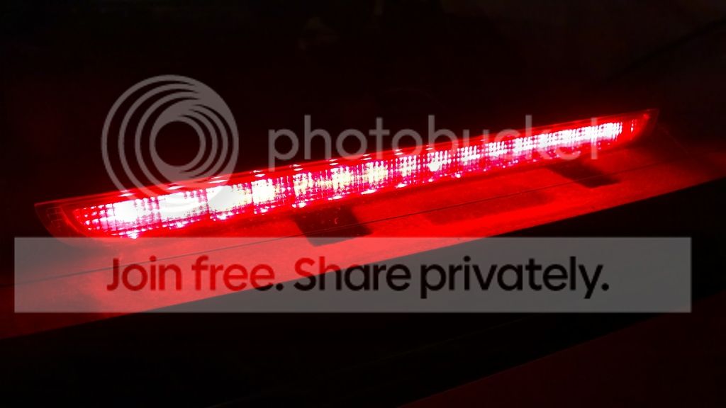

I can’t remember the car I pulled the cc knobs from, I’ve been checking all Audi’s and VW’s when I go to the yard to find them again. I had to sand the bottom down to get the middle hole to grab enough of the metal shaft.
The one thing I have made headway on is wiring up a 04-08 TL highmount LED brakelight. Excited to get that done.

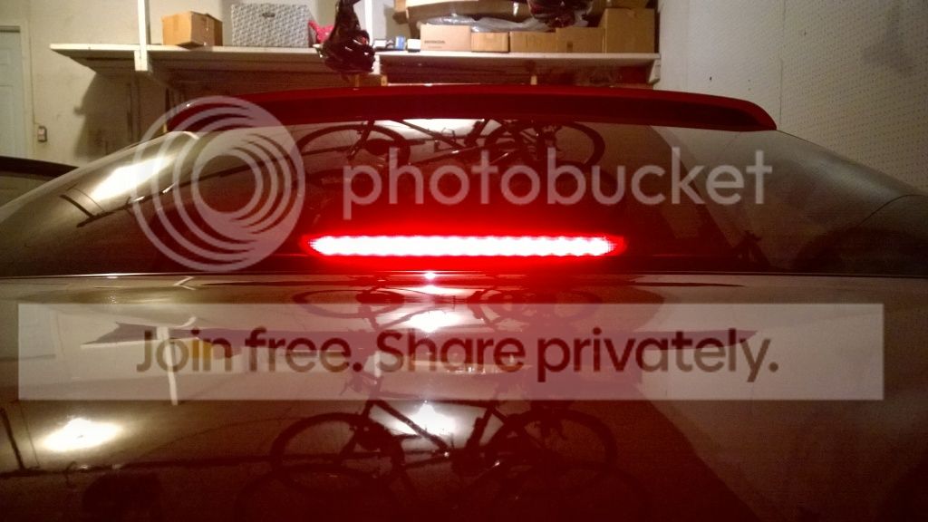

Seats are a nice addition chris! curious to see how that brake light comes out.

That’s weird you sit higher in the driver seat? Is it lowered all the way down? I never put people in my back seat, so I won’t mind having passenger electric.

Here is progress on the brakelight, it’s pretty bright lol. I’m not mounting it on the deck, I want to put it up high but need to figure out a good way to mount it to the headliner. Wish I could integrate it into the roof spoiler.

Love these seats, I like how the RSX seats look Audi RS-esque, but really wanted heat and didn’t even want to try tracking down CAN seats. And these were direct bolt on and perfect condition. It was so hard to find tan perf leather though, black was everywhere lol.
Yeah not sure what performance mods you have in mind, but joint wiring may come into play later. Hopefully you can find a way around it. I’m sure you will if you put together that mess of a dash harness haha.

brake light looks great. I like it better than what i did

Thanks. Yours is nicely integrated though, and I do like the length.

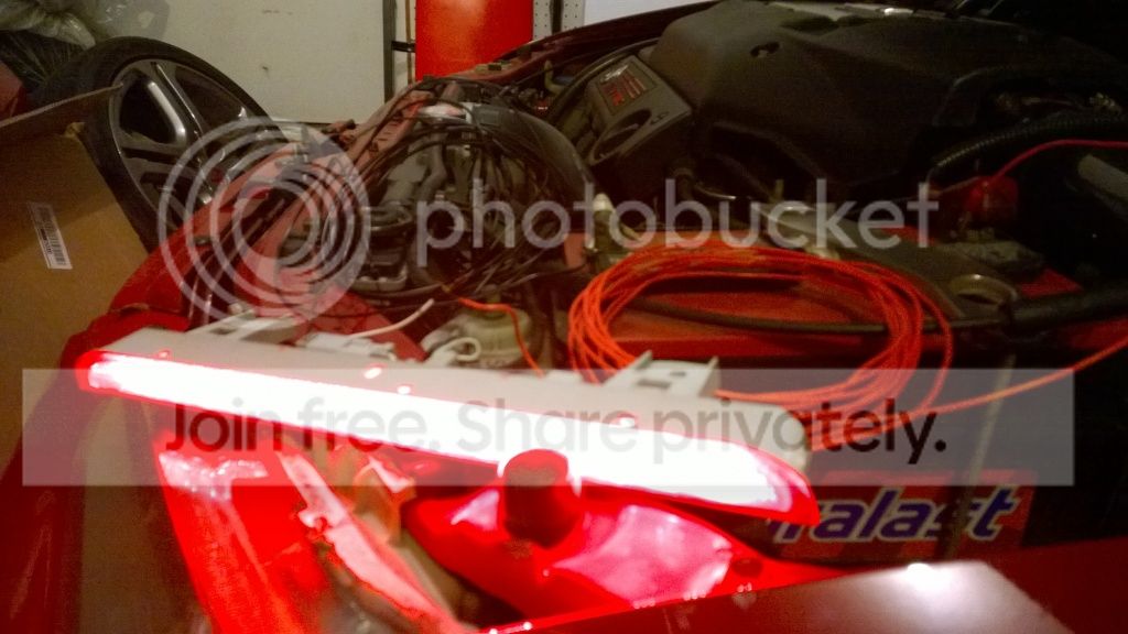

the rear deck and headliner are basically the same material, i know there's some metal channels that the factory middle brake light hooks, acura must be pretty similar, dont see why you couldnt run the wiring up the c pillar and fix it to the headliner. one problem i forsee that you probably already noticed is the angle of the brake light is for the bottom of window, flipping it upside down for the ceiling would reverse the angle and just light up the back seat(my 3rd brake light has broken tabs and comes loose and does it hahah) any pictures of the light assembly?
Yeah, I'm probably going to leave the stock 3rd brakelight where it is so there's no holes in the deck, and just unplug it. The TL assembly won't fit in it so I'll probably remove it and cover the deck in black or red perf leather later. The TL housing has the red lens angled just slightly down. I should have grabbed the plastic TL cover while I was there but it was gray. I'd like to find a tan one then mod it as needed to fit.
To mount it I'm either going to use clips or stick a couple 10mm bolts up through those holes w/a nut on the other side. I was reading about headliner removal in these threads...
http://www.6thgenaccord.com/forums/s...ad.php?t=45778 and http://www.6thgenaccord.com/forums/showthread.php?t=207. I only need to be able to get my hands above the back area of the headliner, definitely don't want to crease it though.
Right side up (the orientation I will mount it in)
Got driver side seat in. Trying to get my hands on the factory CL wiring harness from a junkyard to power/heat these seats.
Added a couple photos of other things I've added recently too.
Its much easier to run your own heated seat circuit, than trying to incorporate the CL one into the Accord. You Have the heated Canadian bezel, the Heated seats you just need the power. Before my Dash swap I ran it like this....
From the drivers fuse box, there is empty slots that are only on when the car is on. This is great just incase you leave the button on you wont drain your battery. The red dot next to the driver is the relay.
The wire coming from the fuse box goes here. To the appropriate terminal.
Also another wire Directly from the battery to the relay with an inline fuse.
From there i Ran it to the switches. (Power wire from battery to relay to switch)
From the shifter console you can light the switches and ground them.
From the switches I passed the wire thru the center console down to the seats and wired it to the correct wires.
Its Simple dont look at it like a mission.
There is more steps not mentioned, but just so you get an idea.
By the way that Cream and red looks good.
THEM PHOTO EDITING SKILLS ARE GREAT HUH? LOL

So, do you need a resister for the 3rd brake light being LEDs? (Not seeing "brake light" on your gage cluster w/ this mod?)
