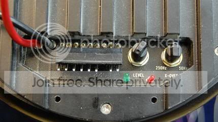

my dad gave me a bazooka tube a couple months ago and now that i'm getting a new head unit for christmas i was wondering how it gets hooked up. I know where the power goes but other than that i have no clue.
Here's what the back looks like.
and here's kinda what the harness looks like

gray wires are a speaker pair (black stripe is ground), purple wires are a speaker pair (again, blk stripe is ground). Blue is remote turn-on, hook to antenna output from new HU or to ignition switched power.
