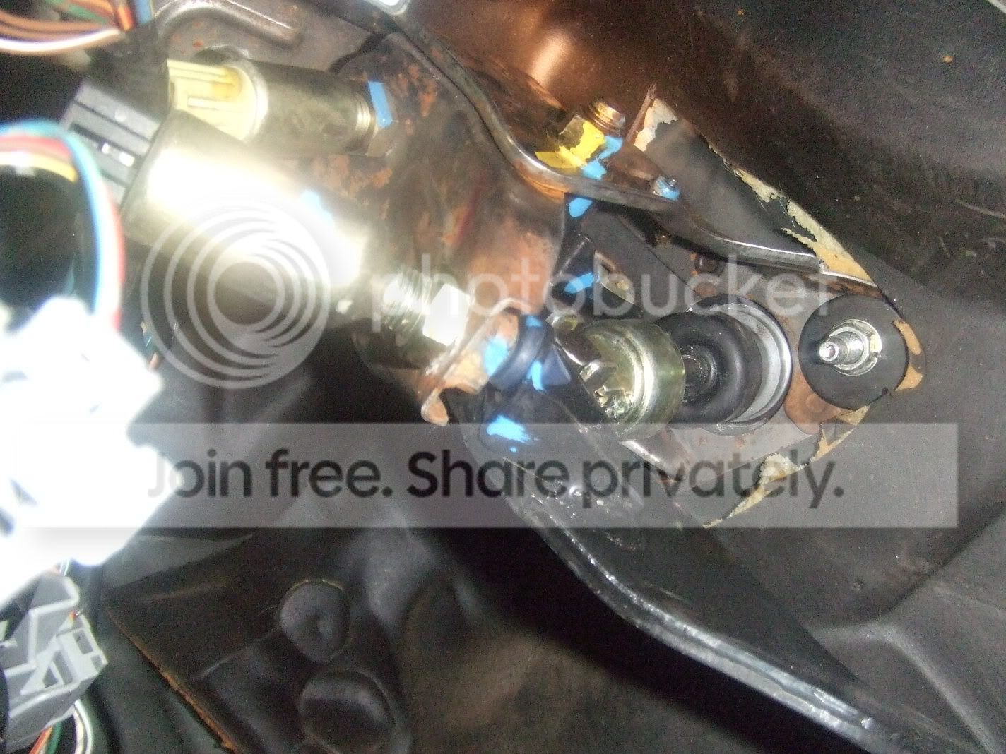

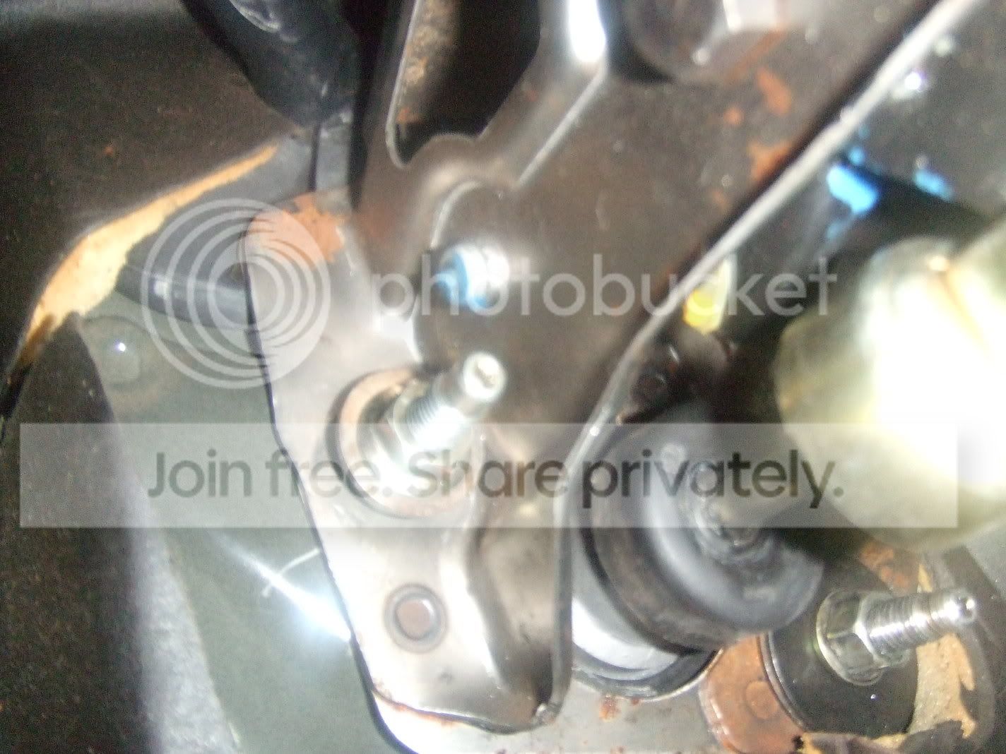

Alright, so I got the car back today from the shop from hell. This is my second time picking up my car. Long story short, since I did a throttle body service and forgot to connect my cruise cable they say they arent liable for the cruise to not be working because I forgot to connect the cable in the beginning. BS now im left without CC. Im pissed.
I had to buy a NEW shift cable assembly at honda. 240$. Now everything is shifting tight and nice. Still! there is a problem. I dont think these people even installed spacers inbetween the clutch pedal. My clutch slips like its not fully engaging. I took pictures of what they did for the clutch pedal. Can someone please help me out. I am F-ing tired of giving my car to these douche bags. 1,760$ I paid. I plan on taking the car back there tomorrow but if you guys can tell me how to TELL them how to do their job that would be great.

Yes for sure get the spacer in there, I don't have my car with me to take pictures it's a easy fix. I was driving for a few months thinking I had a bad trans or clutch it was a real pain later to find out it was like a $2 fix lol.
the spacers go behind each bolt right? or behind the whole pedal bracket on each stud? there is three. One on top and two on the side. LOL that sucks. Im not trying to burn up my clutch. the funny thing is that sometimes it seems to get better and then come back. is that the same symptom u had
