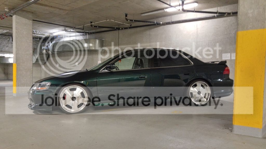

Re: 604ACCORDS 98 Sedan (H22a/5spd swap *in progress*)****LOWERED!! 3/11/2016****

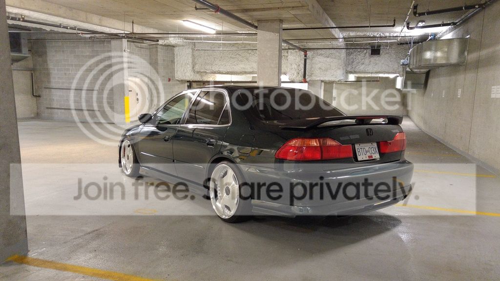

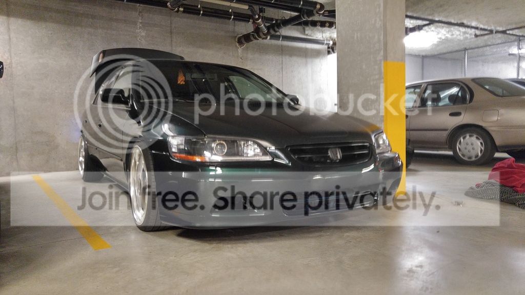

I woke up to this pic sent from my bro this morning :waytogo:

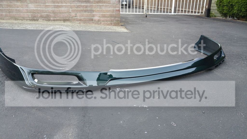

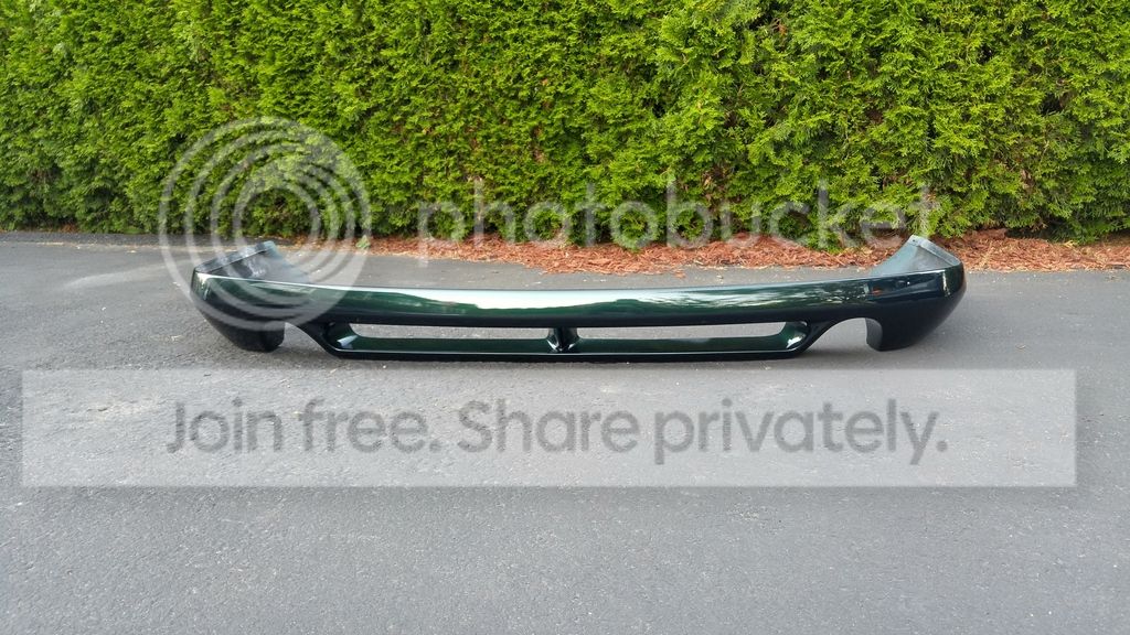

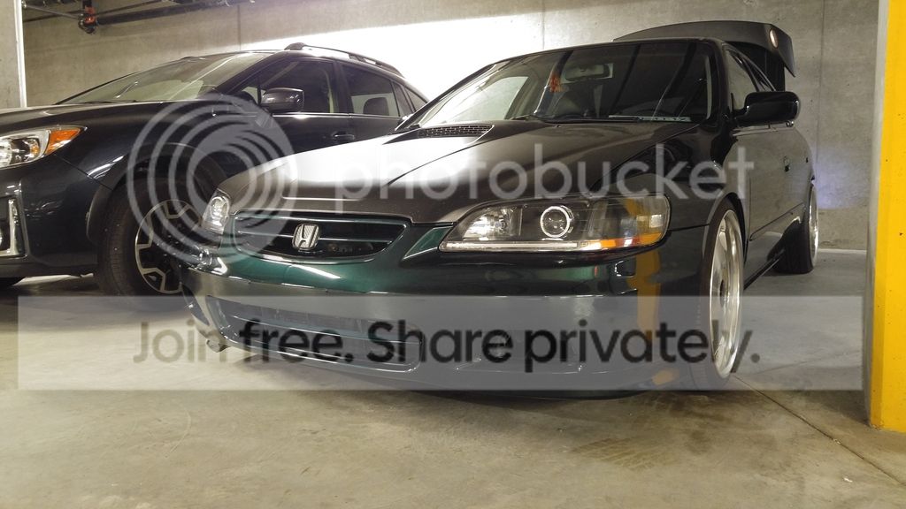

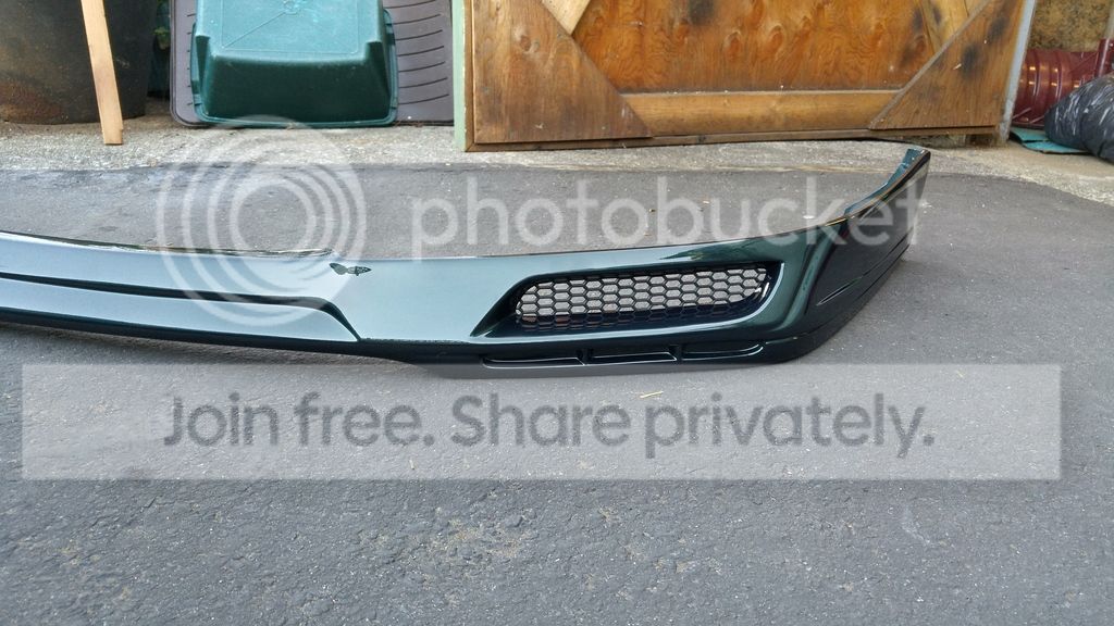

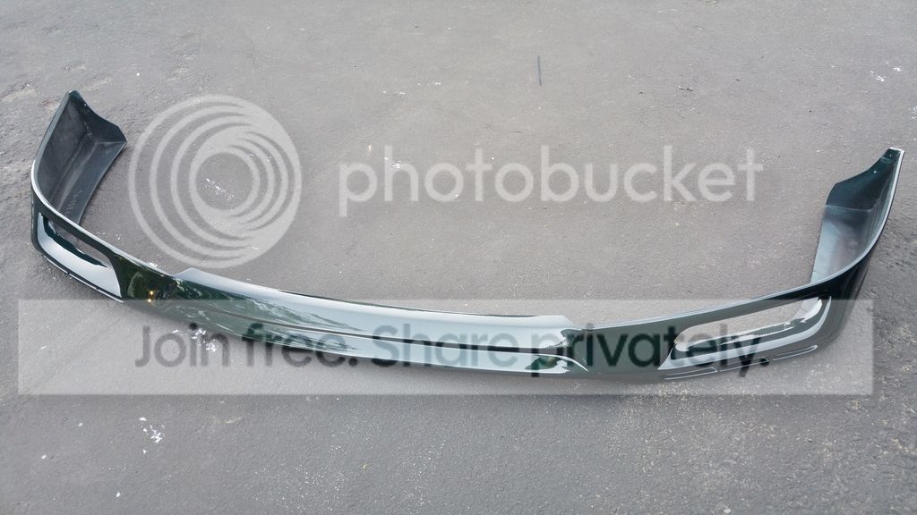

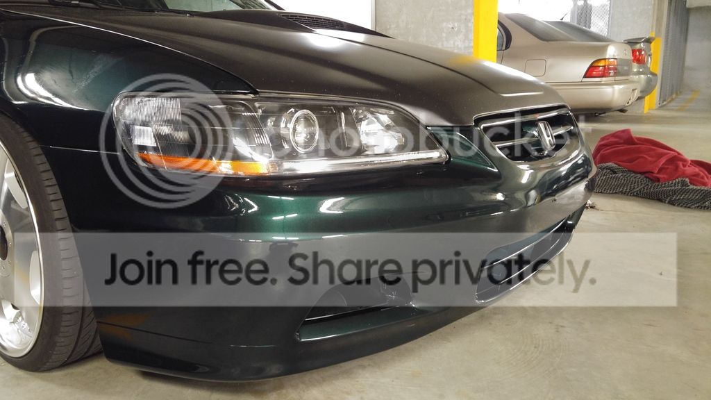

so here it is.. The almighty DEP.. God it looks awsome, bumpers are just sitting on for now they will be installed with skirts tomorrow, lips are dropped off at my shop and will be installed on monday. Test fit one side of mesh on the lip, I love it.

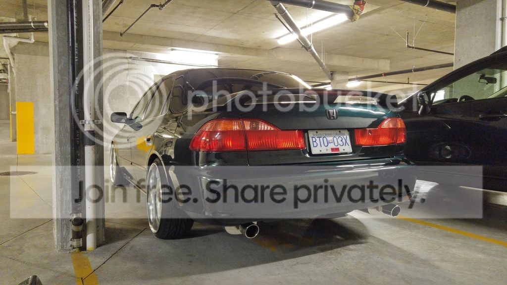

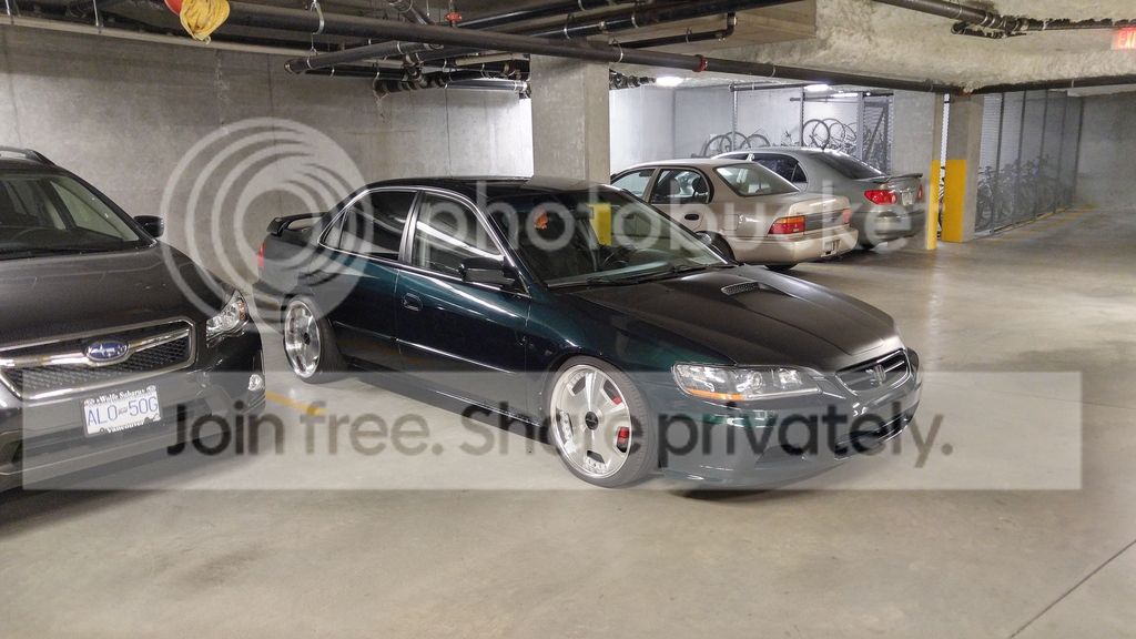

All ready for the show today, I'm leaving in a few hours will post up pics of the show tonight.

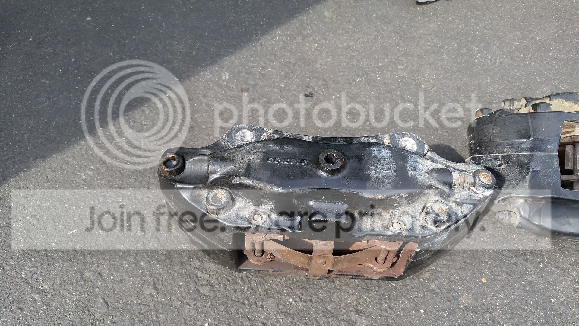

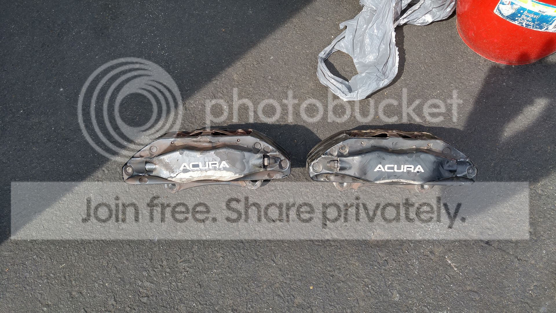

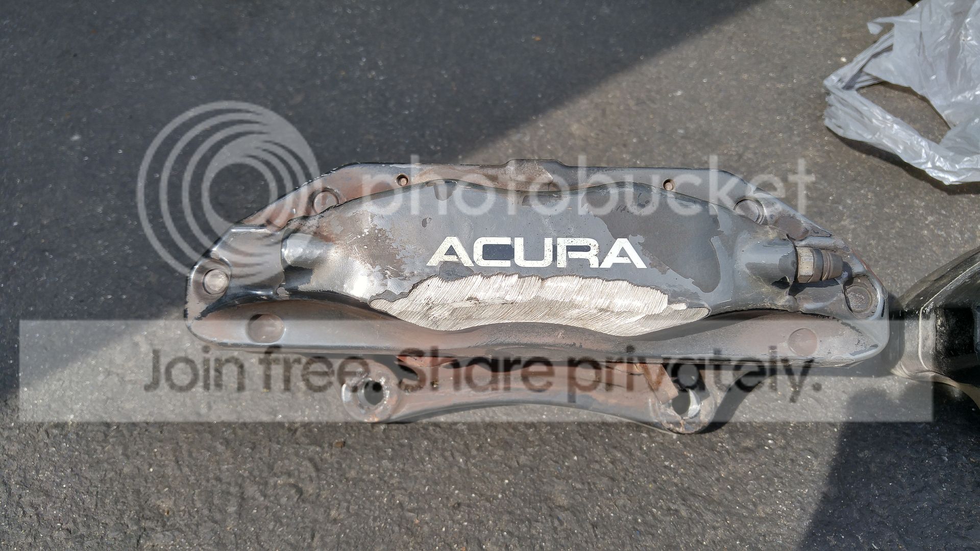

Got all my stuff today half shaft and all, except for hydraulic parts. So I'm peeping around the yard and I stumble on brembo tls calipers, scurried up to the guy and asked how much... Ya ready for this 50 bucks for the pair!!! So like flash Gordon I'm back at the Tl get the lines off get one bolt of driver side and of course the bottom one is seized and destroyed the innards of my ratchet. **** my life !!! I'm heading back with a 2 foot breaker bar tomorrow. Only thing I don't think these will work with my rims so it might be time for some spacers and a camber kit up front.

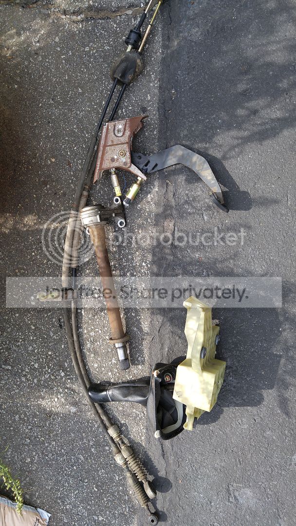

Got all my 5 speed swap stuff on the go now just need a manual computer and hydraulics then it's ready to go.

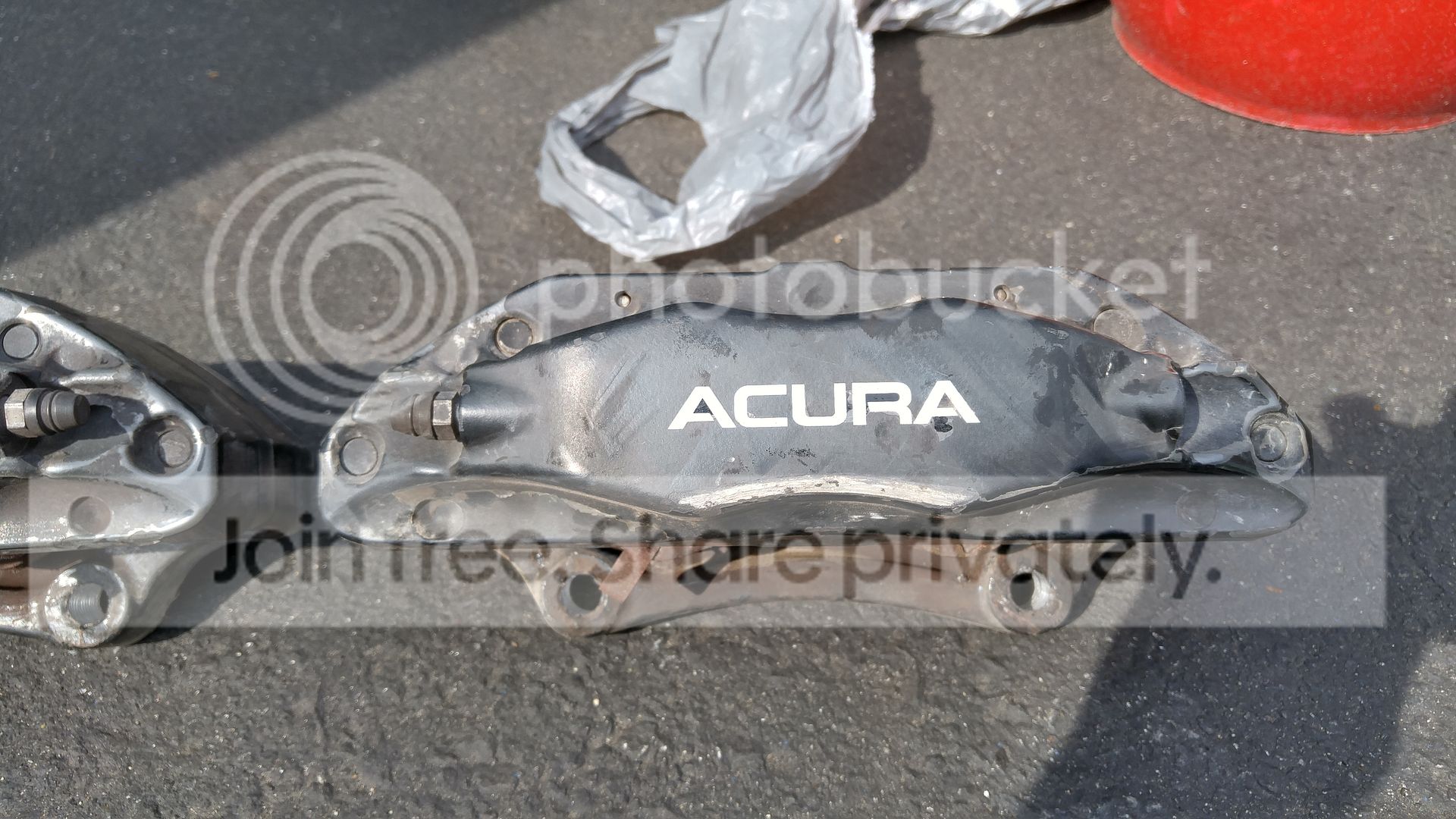

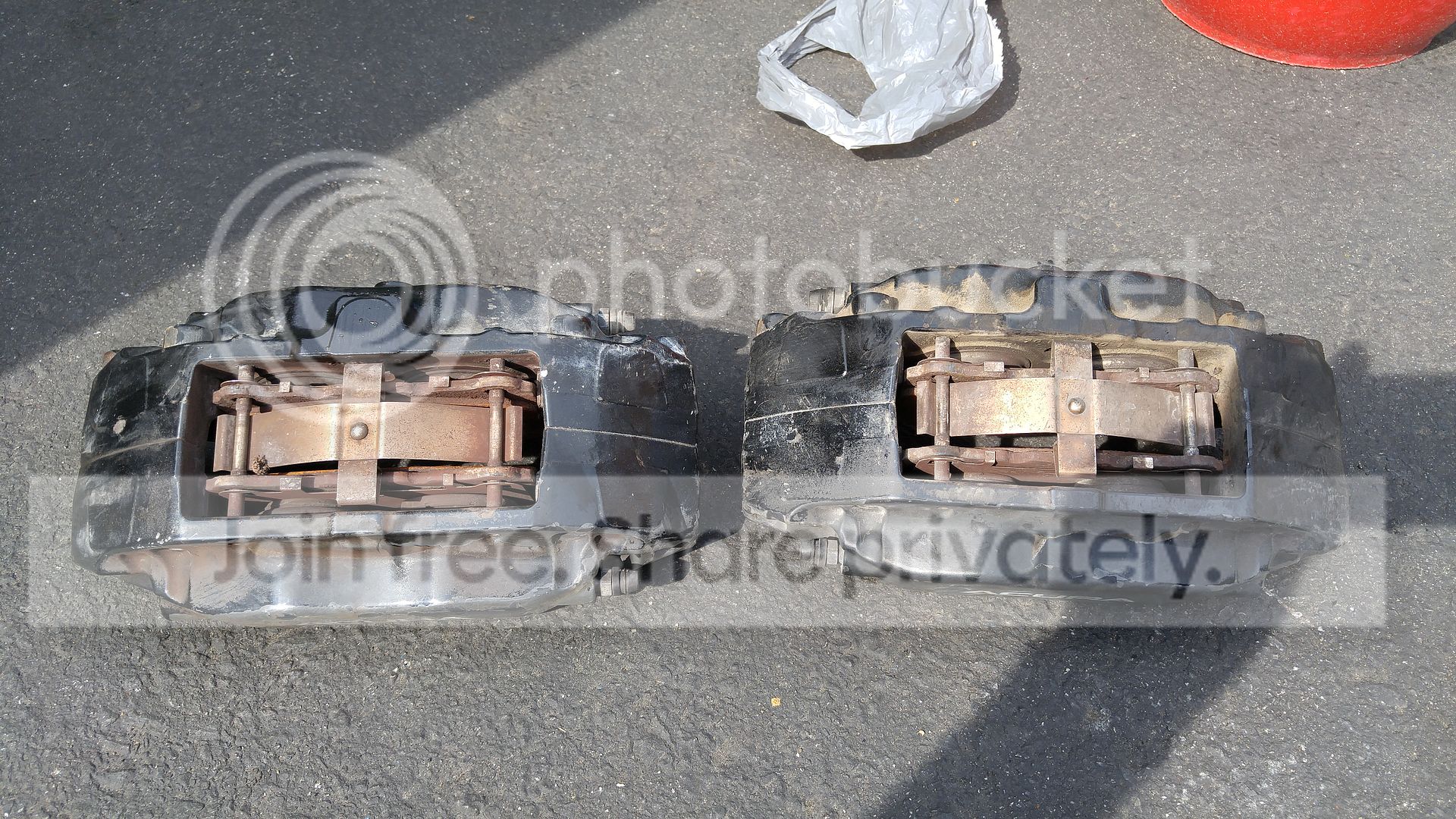

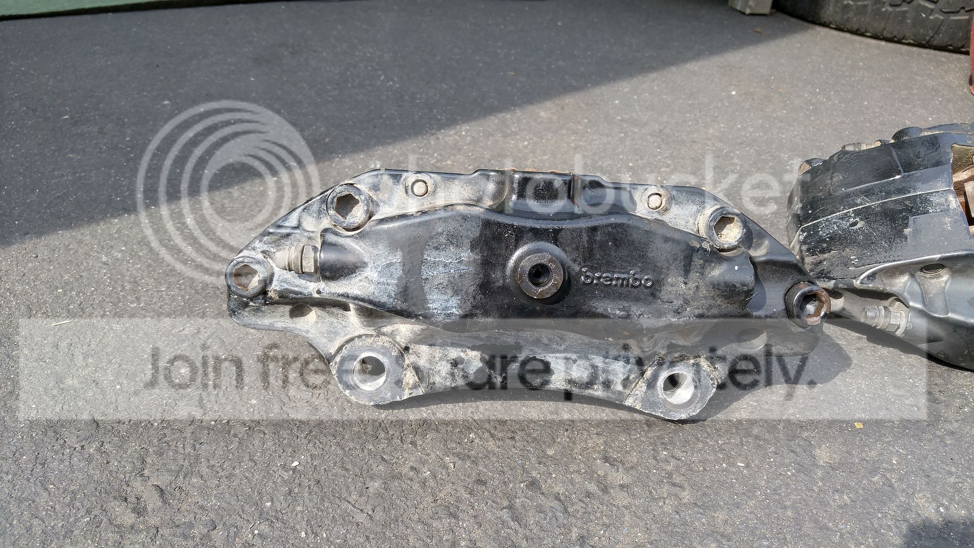

On to the brembos so 56 bucks tax in!! from what I seen on another post here these bolt right up with the use of s2000 rotors. I'm assuming I will need a spacer this pushing my rim out requiring a camber kit. The bolts were over torqued and stripped 3 out of the 4 holes by who ever did the brakes last so I'm taking them to my machine shop to see what options I have. They are not in the best shape looks like someone ground one down a little to clear a rim. Basically I will bead blast them, rebuild them and powder coat them red possibly with white accord lettering. I will sand down where they ground it so it is at least smooth and not so noticable, but for what I paid I'm not worried if this don't work out. First step is to see what can be done for the threads then test fit them with my wheels before I rebuild them just to see if it's even possible to use them.

Lucky *** find..... Haha those are gonna be sick on the accord. Heads up on the powder coat though. When I powder coated mine it warped the calipers and the pistons wouldn't go in. Pretty much ruined my caliper. Everyone else powder coat theirs perfectly fine though so maybe I'm just the unlucky one LOL good luck can't wait for more updates man!

Thanks for the heads up man! Always wondered that about powder coating, guy I called says he does lots of calipers with no issues....I got some quotes today and dropped calipers at buddys machine shop says he can fix them no problem. Gonna be about 40 bucks so not bad.
Heres the list of money this operation will cost I will update as I go:
Calipers- 56
Repair threads- 40 (quote)
Rebuild kits- 42 per side (OEM)
Powder coat- 250 (quote)
Caliper mount bolts 3ea (Honda)
S2000 rotors-__
G35 pads-__
10mm Spacer with extended studs- 150 both sides
Awww geeze this is adding up!! once I get them back I'm going to bolt them in to see what kinda of spacer I need.
