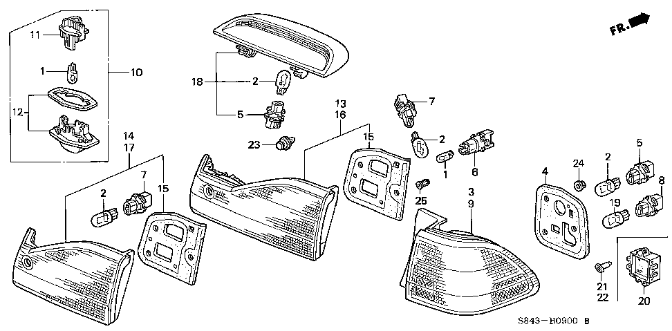

Is the problem just the driverside brake lamp or is it your complete taillight that is having this problem? My suggestion would be to check and see if the mechanic swapped over the stop lamp sensor that goes behind the driver side brake lamp assembly and check to see if that is plugged in.
Part #20.
Jephu- All my brake lights are burnt, I will check to make sure the mechanic swapped over the brake lamp assembly and if it is plugged in. im hoping its just a fuze or the bulbs. Thank you for your help. I will PM you when im ready to order the LED lights. Thanks again guys...
