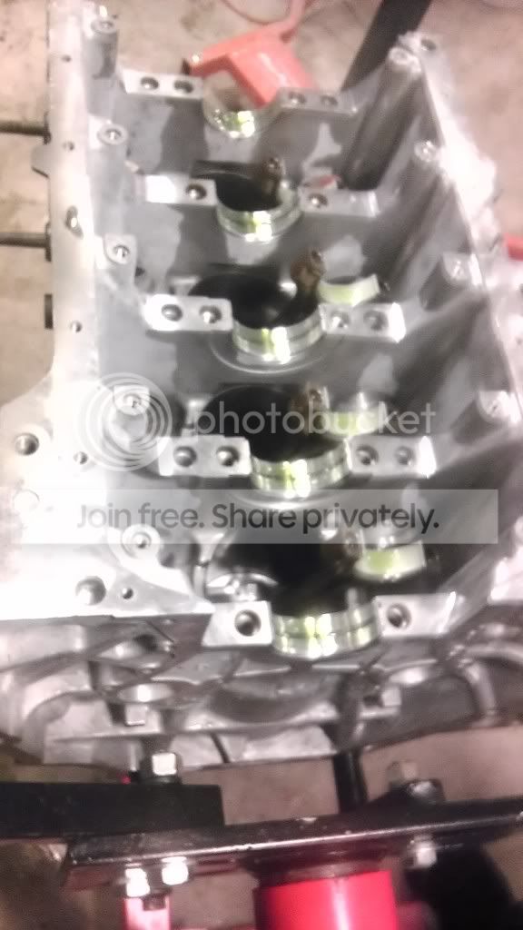

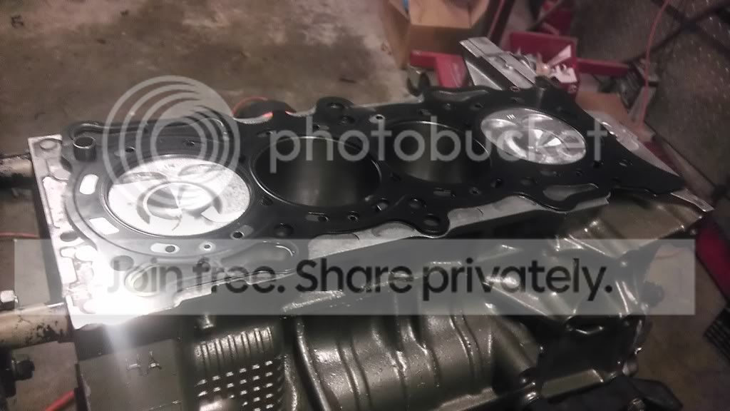

k20 pistons installed on f23 rods
Clutch installed.

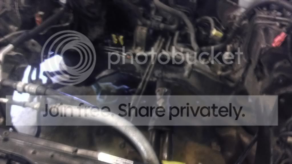

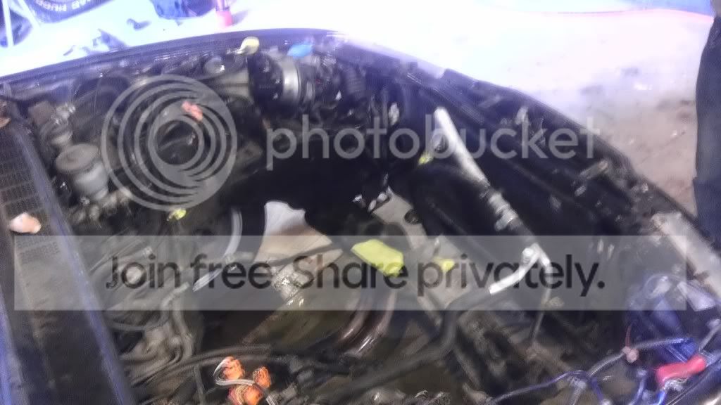

Installed.

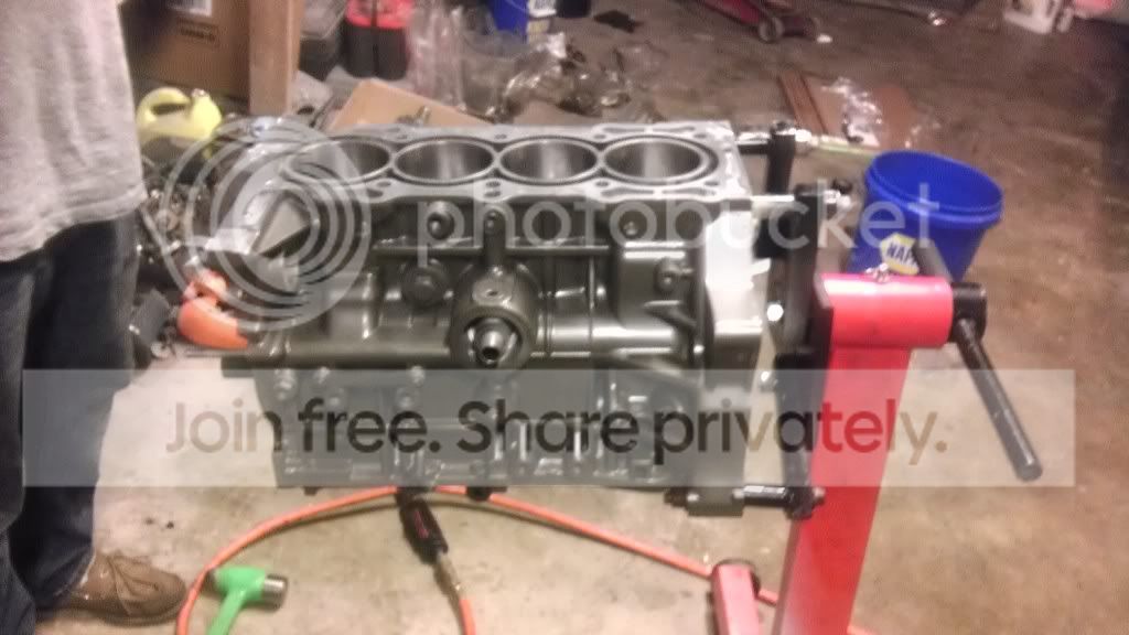

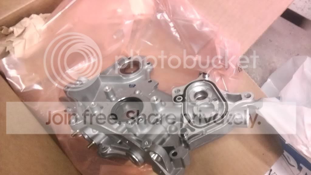

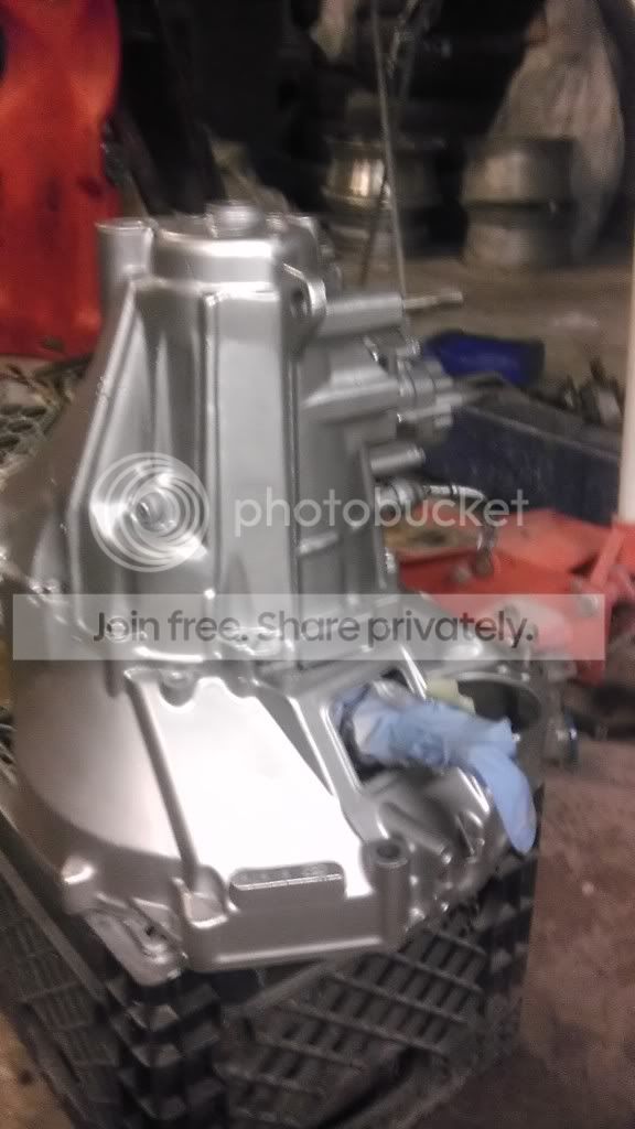

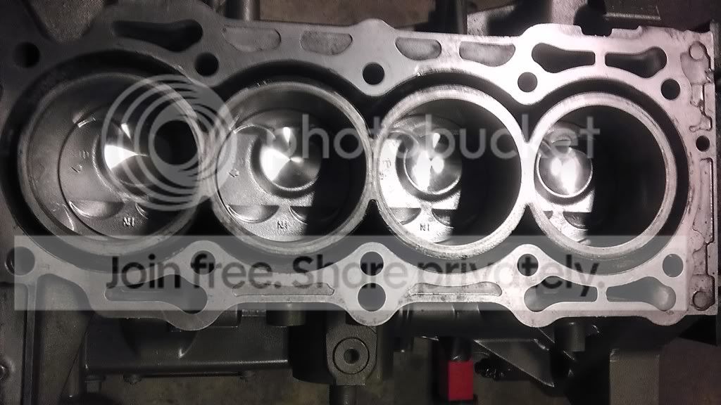

Rest of the pics. The car is also his daily driver.

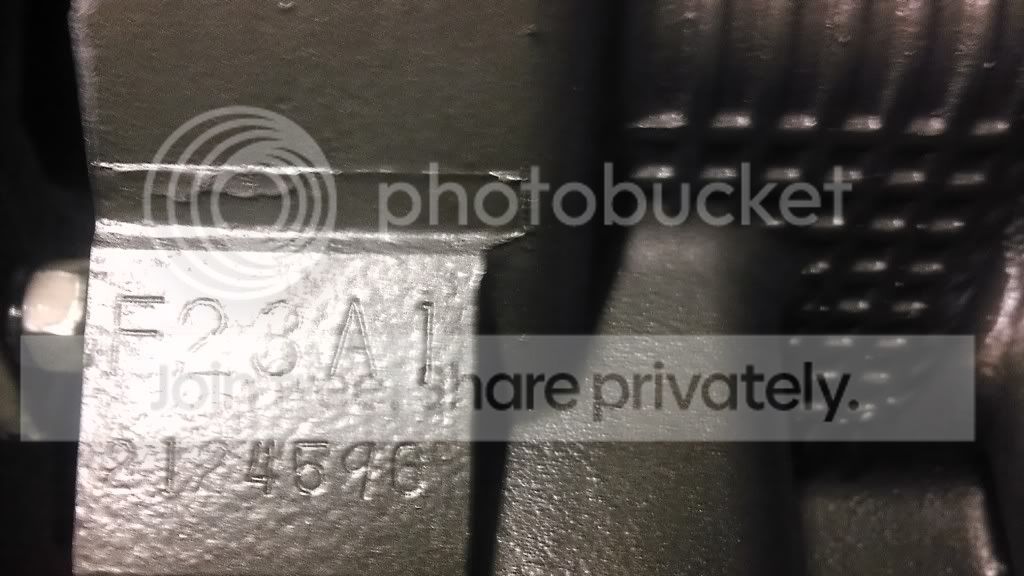

F23a1 block
K20 Pistons
OEM Honda Parts

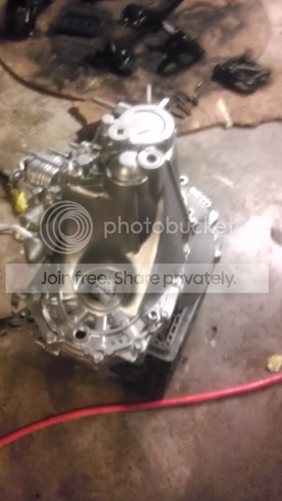

Fresh Paint on the Transmission

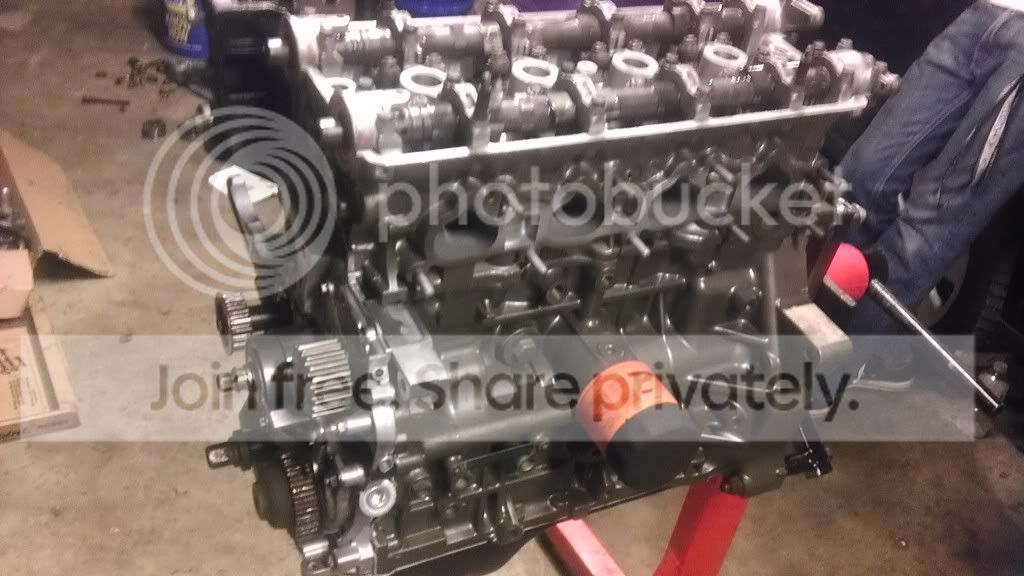

Nice build! Please take that orange turd off the block though, so much effort is being trusted to a coffee filter.

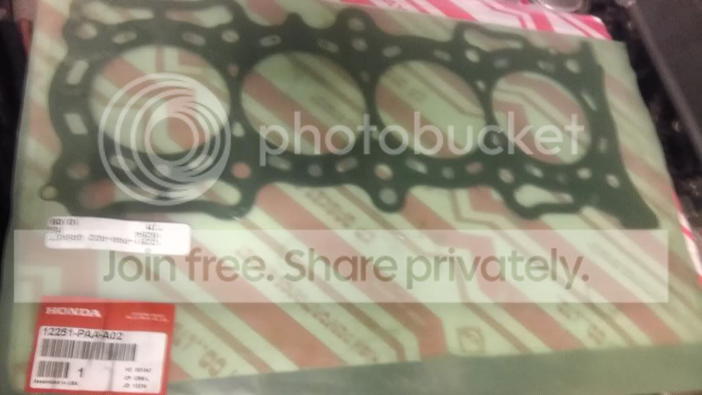

With the h23 head do you still have to block off a hole on the block and head?
Actually didn't have to fill any ports. Forgot to take a pic of the headgasket on the head before I installed it though. Built the motor and installed it over a weekend so was kind of in a hurry.lol
LOL No worries there. Actually have a honda filter on the motor once it started.
