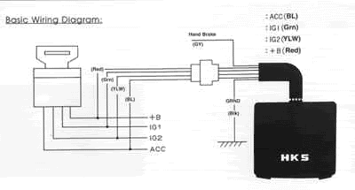

Did it come with instructions?? If you can tell me what wirs you need to tap, I can tell you where to find them.
Totalimmortal
Mar 4, 2006
2,897
14
Westminster, CO
BAM! It took me three minutes to find this wiring diagram.
B+(12V) is a solid white wire at your ignition harness.
Ignition is a black/yellow wire at the ignition hanress.
Accessory 1 is a solid yellow wire at the ignition harness.
Accessory 2 is a white/black wire at the ignition harness.
Parking Brake is at the parking brake, you'll see it.
Start with the first accessory wire when you're hooking it up, and then go to Accessory 2 if that doesn't work. Have fun!!:D
