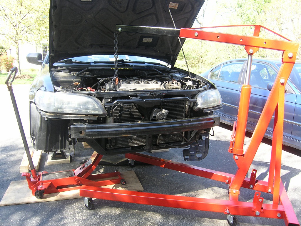

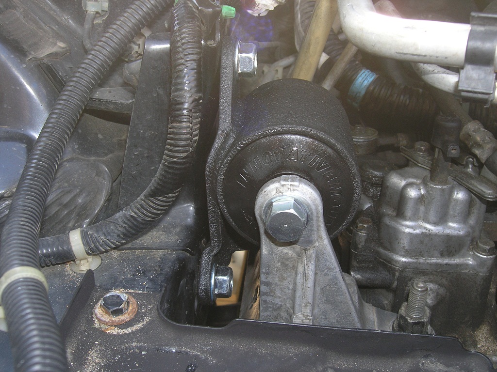

Finally!! The updated transmission mount fits PERFECTLY!
It took a while to find the time; I figured I'd wait until it cooled down a bit but today was a scorcher!
When I installed it, I had an engine hoist on hand. I connected the hoist to the loop that I moved from the right side of the engine block to the left side.
Something similar to this (ignore the jack and the removed bumper as this picture was taken when I was replacing the clutch):
I'm sure the same thing can be done with a jack carefully placed under the transmission; since I have a hoist, I took advantage of it. Be sure to use a large block of wood between the jack and the transmission.
I removed the air intake and battery before removing the original mount. This way, there is more room to work. Also remove the bolt holding the battery cables and A/C tubes to the battery tray (torque spec: 7.2 lbf-ft).
After removing the original mount (including the aluminum mount bracket that attaches to the transmission), I found the best way to install the Innovative mount was to:
  1. Install the mount on the chassis to spec (47 lbf-ft)
  2. Loosen the front engine mount bolts (the mount to engine bolts; 3 x 14mm)
  3. Lower the engine hoist slowly. It can being lowered but no need to move quickly.
  4. Put the aluminum mount bracket in place (note that the poly on the new mount will prevent fitting very easily)
  5. Raise, lower, repeat as needed to get the through bolt in place. This is a royal pain given how tough the poly on the new mount is.
  6. Tighten the nuts that attach the aluminum mount bracket to the transmission
  7. Lower the hoist completely
  8. Tighten the aluminum mount bracket nuts to spec (28 lbf-ft)
  9. Tighten the through bolt to spec (40 lbf-ft)
  10. Tighten the front bolts to spec (27 lbf-ft)
